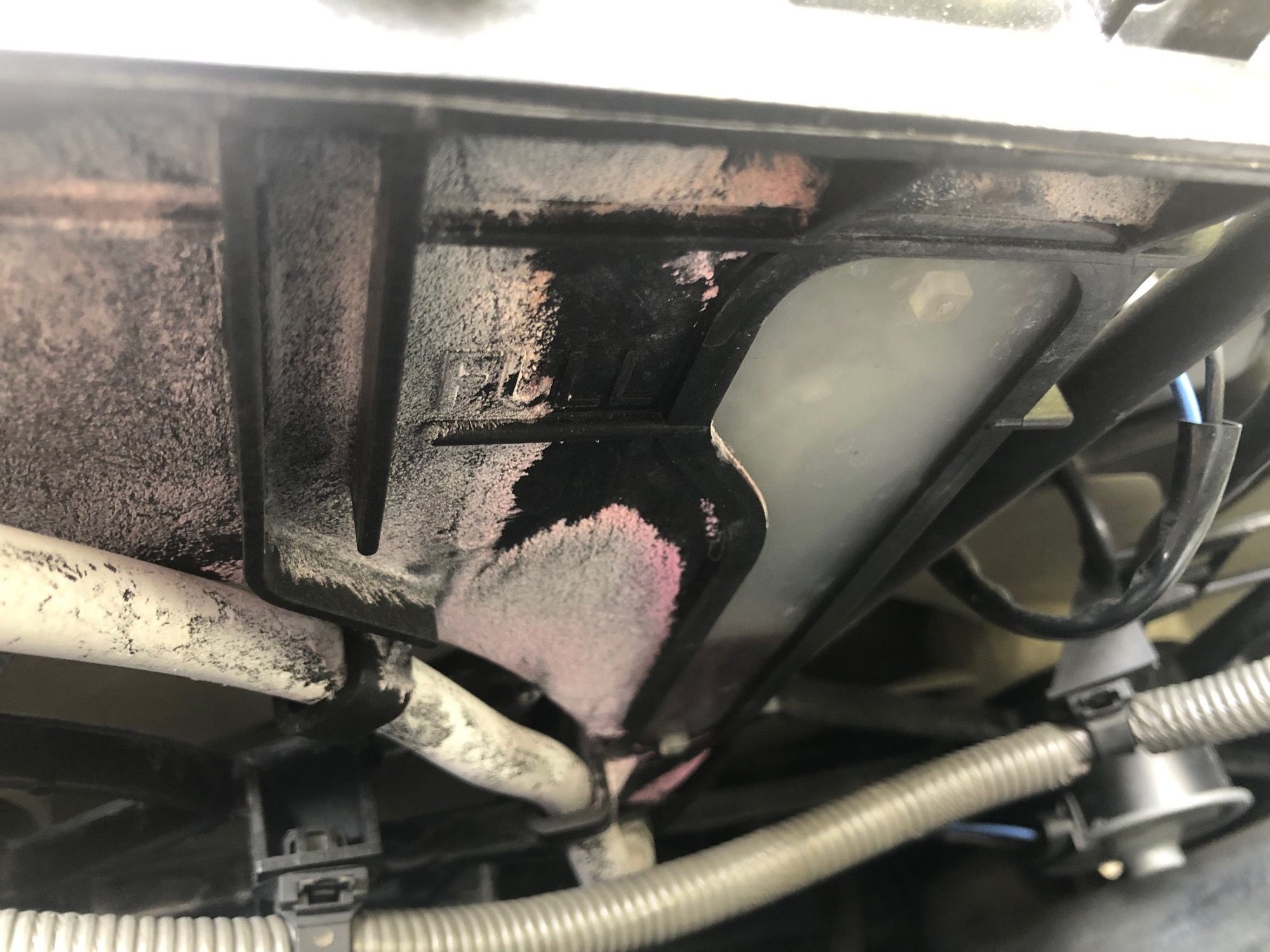

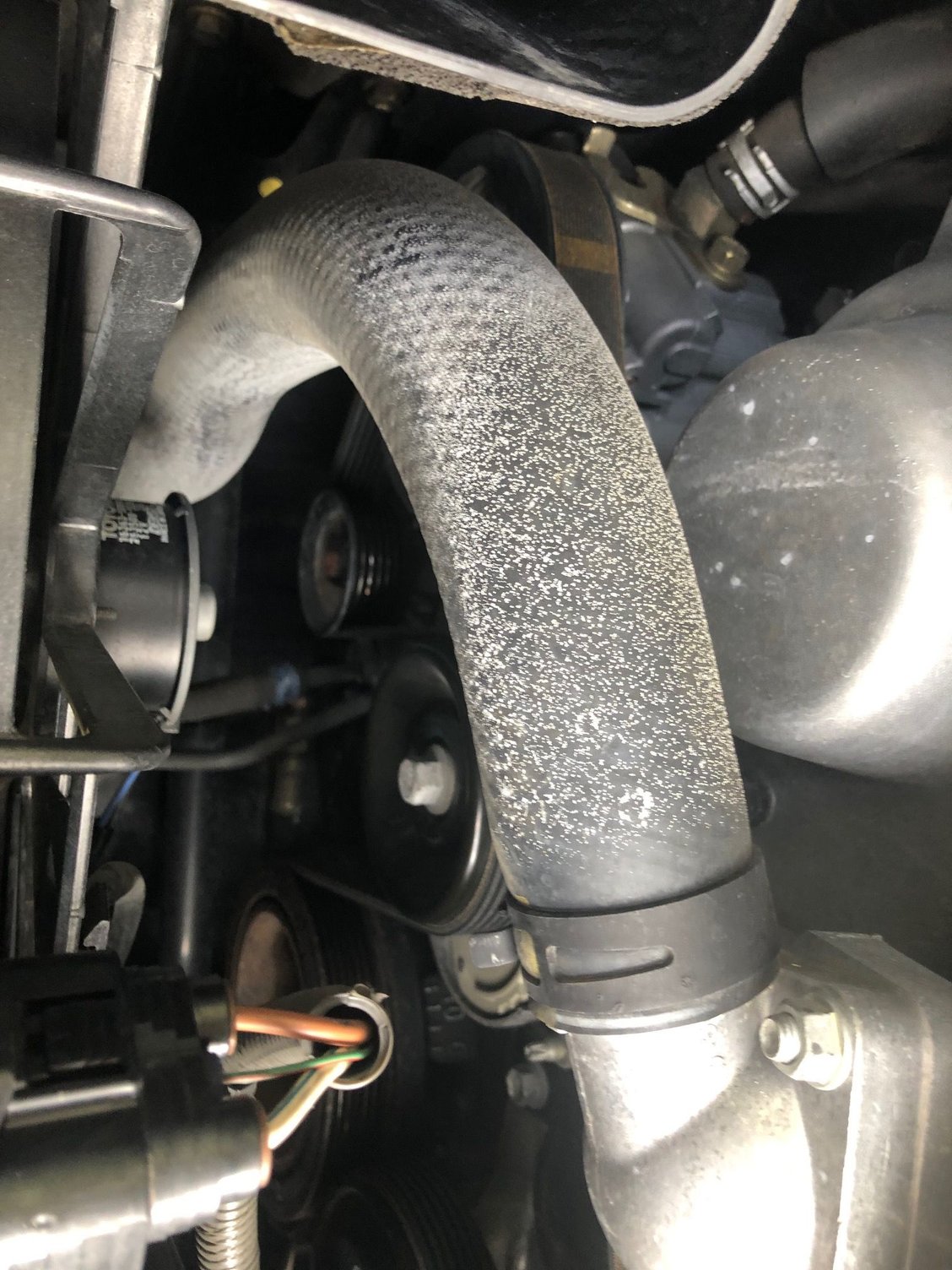

The issue - Right away I noticed a white dusty covering on all of the radiator and coolant hoses - even the ones behind the engine - I figured it was just dirty. I guess as I was looking at before the sale it didn't register to ask a Master Lexus Tech what it could be - that's my big mistake. So, I drove it home 400 miles and it was as smooth as butter. However, I took the radiator cover off for my first super cleaning of my new ride and noticed that the coolant level was low, and there was dry pink crusty coolant resident all over the backside of the reservoir. There is also dried coolant residue around the radiator cap and reservoir cap. There are no drips anywhere, and the coolant is not mixing in with the oil - the oil looks great, and the engine temp stayed the same on the long trip home.
I texted pictures to the previous owner seeing he's a Master Lexus Tech, and he said the coolant must have evaporated over time (sitting), and that's the residue from that process. He said he did not take that cover off before sale, but flushed the coolant last year before he parked it for the winter. He said it was normal and to clean everything up really well, fill the reservoir with Toyota coolant while the engine is cold, and keep an eye on it as I drive it over the summer. If there is an issue it will show itself sooner than later, but he was confident in his texted picture diagnosis.

Quite common although yours does look excessive. How often do you need to top up reservoir? You can pressurize system, although most of your residue is coming from the reservoir which is notorious for these stains. If there is nothing wet and if you are not adding often, I wouldn't worry too much, but you still might have a leak at the reservoir which can be pricey as it comes with the shroud. Good luck.

you need a new radiator or coolant expansion tank, one of them is leaking.. The while/red speckles on the hoses are from water hitting the rad fan. You have a leak somwhere, that is not from evaporating

Don’t get too upset just yet. There’s a lot of residue on and around the rad cap. The rubber seal in those becomes hard fairly quick from heat cycling. The small rubber hoses between the rad and external reservoir are also a weak link in the system. These are things a child could replace without bending over at the dealer…

Radiator cap looks like leaking either from bad cap or over pressure. Change that first and clean all pink residue. As for radiator it has a plastic top and if not bad now with leaks will be. It is a very easy straight forward job replacing and aftermarket radiators are available for as low as $68 that work.
