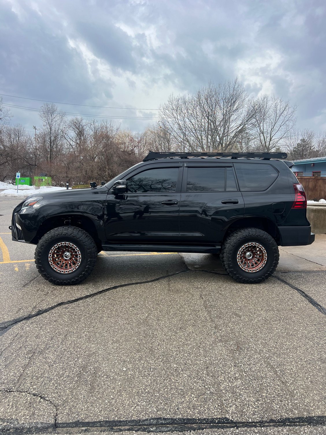

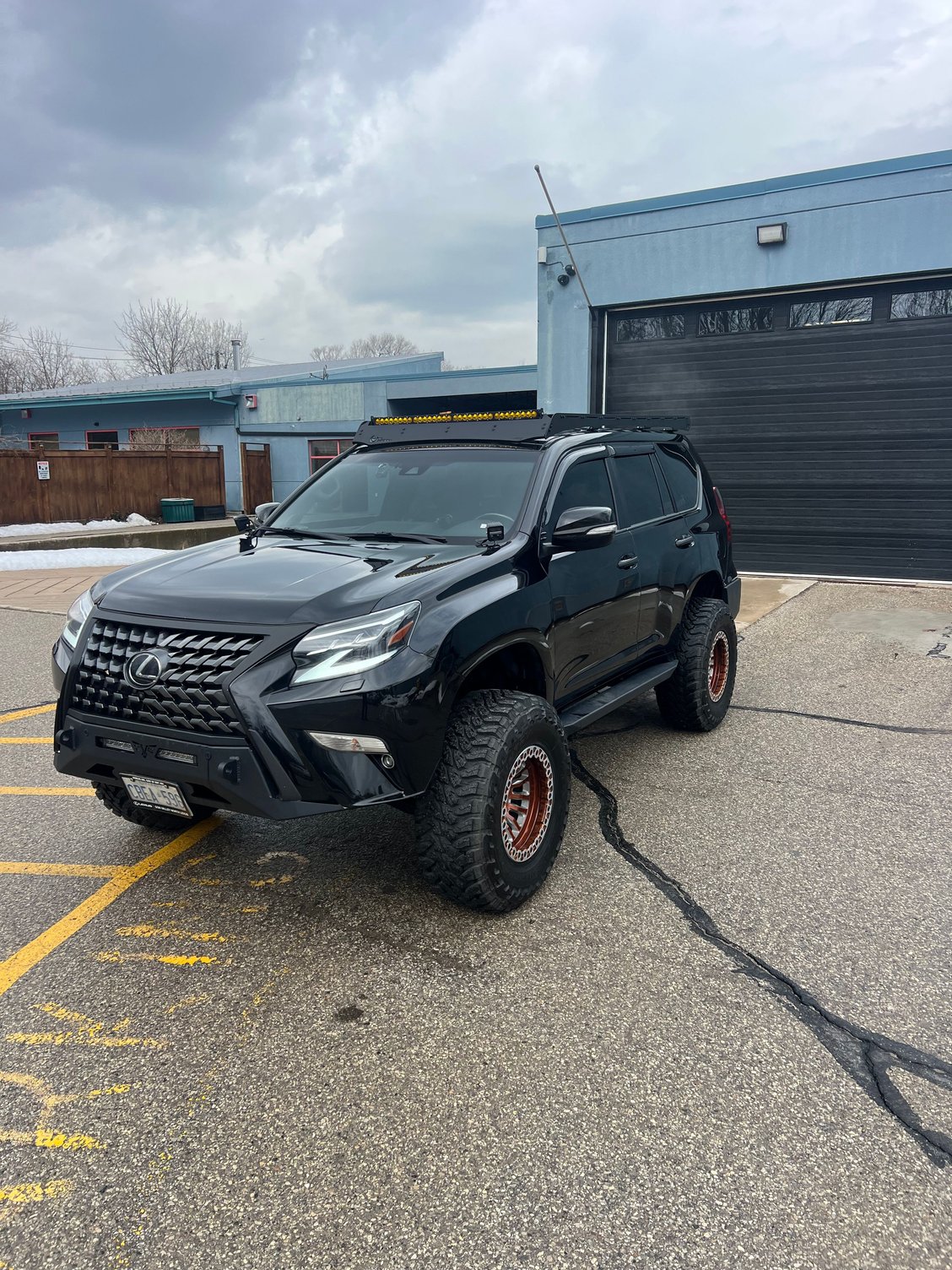

I've got like a 2" rear and 2.5" front... I think

Looks great! What size tires?

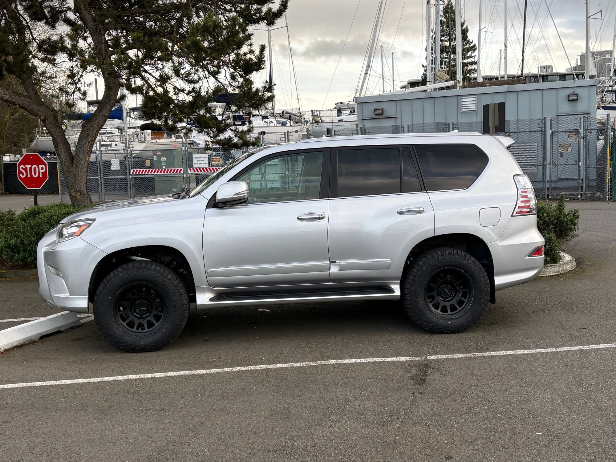

Finished today. 1.9” front (#6), and 1.5” rear springs. 275/70/17 on Method 703, zero offset. Bilstein 6112/5160. Dr KDSS, and Ironman UCA.
