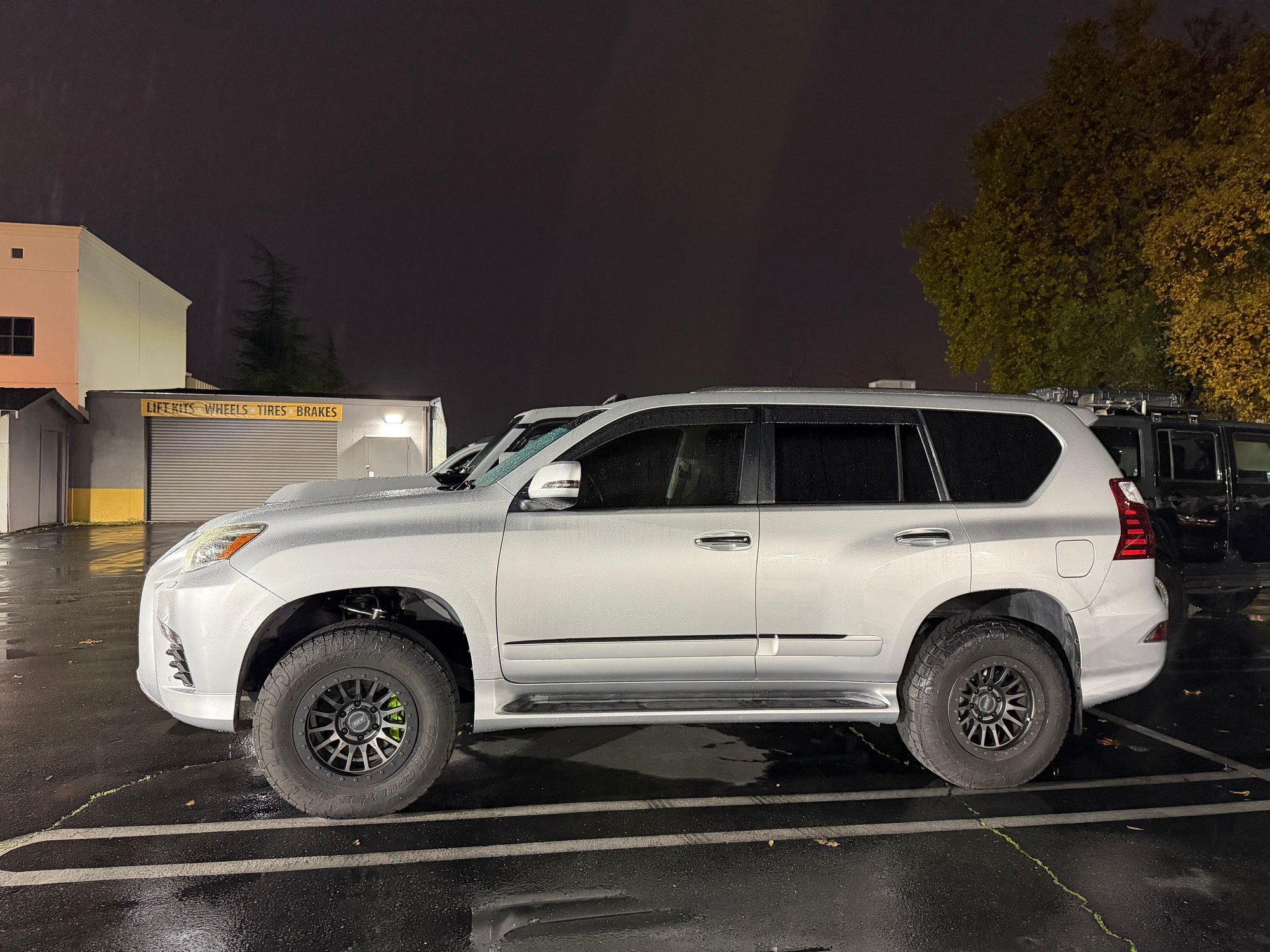

Hello,
this past Friday I had my gx leveled with the bilstiens and now my front right tire rubs the side steps. I was debating on just cutting off the inner portion of the step but I don’t know if I really want to cut into it. The current caster is set at 3.6 Driver and 3.3 Pass. From my research a lifted gx should be between 2.5 and 4.1. Being that the current alignment is basically in the middle of the recommended range. What’s peoples opinion on adjusting it to where it no longer rubs or just cut off the side step rear. I’d probably have to cut off about 1.5” from the bottom rear of the steps.
thanks in advance.

As for the parts installed on the gx they are the bilstien 5100s with dirt king UCAs. Wheel are the RRW7H 17x8.5 -12 with 265/70/17 Toyo.

... it's the -12mm Offset ... stock +25mm to -12mm places a stock sized tire 37mm (1.5 inches) in the outboard direction ... with an approximate 2:1 loss in clearance to the front body mount. No way Caster can compensate ... maybe 0.5 inches of (move forward) additional clearance.
Have 265/70-17 Nitto A/T's on 8.5/17 wheels with +1 Offset ... dead-nuts centered in wheel well and am JUST on the hairy edge of rubbing with a fender liner pull-back both fore and aft.

... lift does nothing for clearance ... pre / post lift the suspension follows the exact same path from full compression to full droop. Lifting actually places the resting tire centerline more in line with the side steps and front body mount, so actually makes that worse for non off-road users. The -12mm offset is the bigger factor causing the interference.
