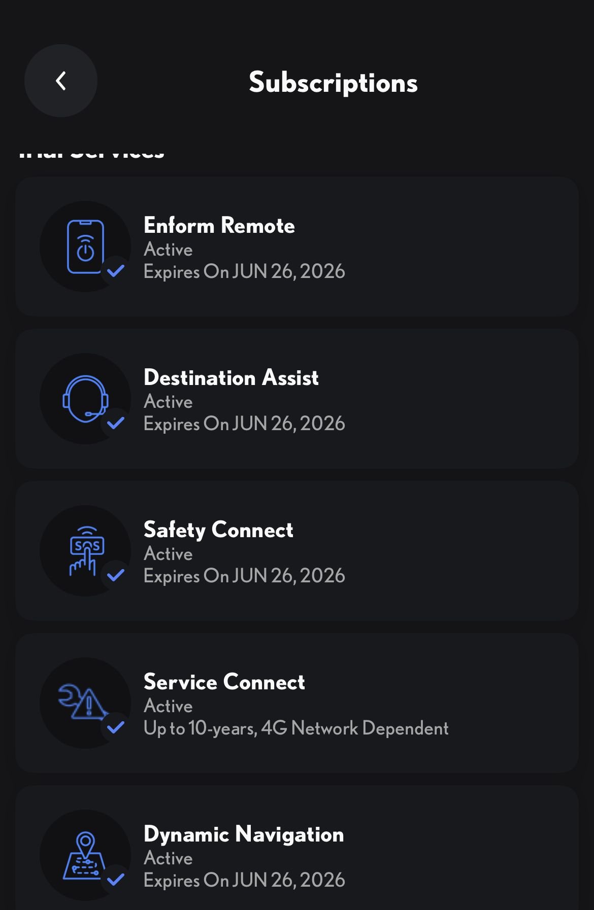

Just recently the voice to text function on our 23 GX stopped working and we’re getting this error. It does work when connect via usb and using Apple Car Play.
All other voice functions such as changing the radio and making calls are working. Only the speech to text gives us an error. I’ve also disconnected the battery for approximately 10 minutes but that didn’t help either. Checked for updates on the infotainment and it say’s it’s up to date. Turned off the iPhone and back on as well as tried another iPhone but nothing works. This just started today. All subsriptions are up to date. Does anyone know the fix or having the same issue?

The error seems associated with online services. You should contact Lexus subscription services if for some reason that your VIN was no longer active.

Per the app, all are active. It’s less than 2 years old and the subscriptions are good until June 26 2026
