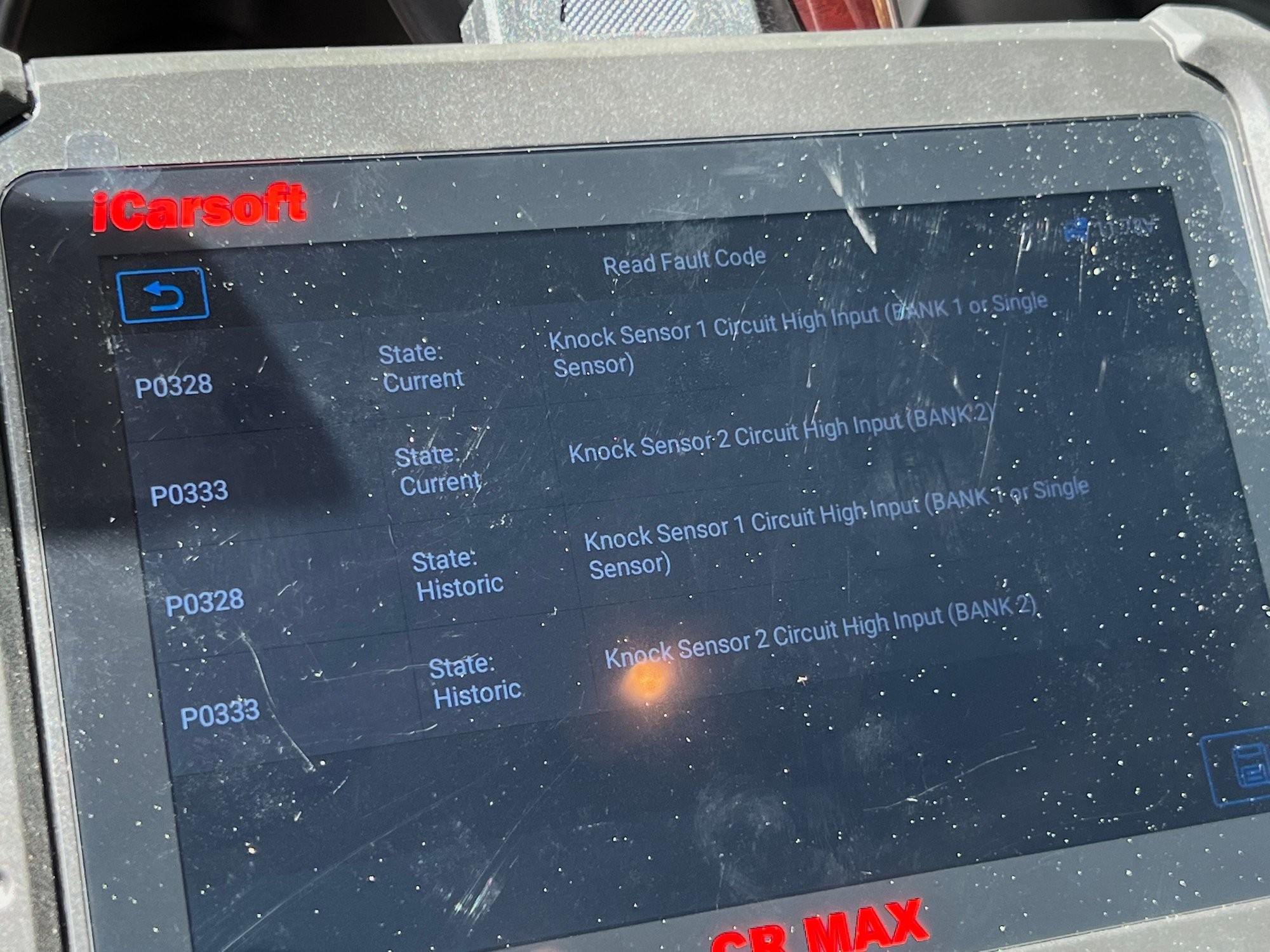

Started my ‘08 GX this morning and felt the engine hiccup and then got a check engine light. 2 knock sensor codes?? Cleared codes and check engine light pops back on the second I start the vehicle. Any ideas? Is it ok to drive to a mechanic? Idles fine but runs a little rough under acceleration.

You can drive to your mechanic just take it easy on the throttle. Bad knock sensor signal will trigger a code right away.

They're both located in the valley of the engine next to the starter.
As far as I can tell the common reason for them going out is a rodent eating the wires.
Given the labor cost to remove the intake and get in there, think about replacing the starter if you're still on the original.
