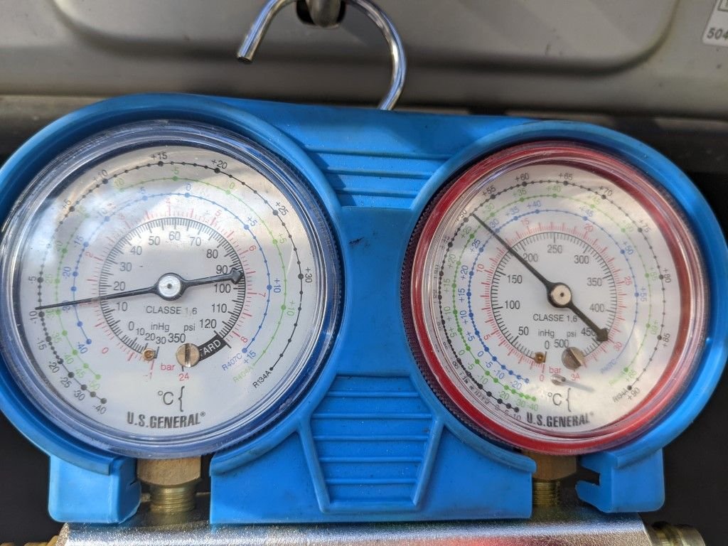

Hey y'all, I was hoping I could get confirmation from the hivemind that my AC needs more freon or if something else is wrong. The AC is not blowing cold, it gets a little cool on the passenger side but not cold like I would expect.
I suspect it has a leak in the lines running to the rear AC evaporator. I do have pressure, but it seems low, here's the reading on the gauges with the AC on full blast:
Now I know PSI doesn't directly correlate to right/wrong charge levels, but 15 seems very low. Given this temp chart I found:
I would expect it to be in the 25-35psi range (it's in the mid 60s today and according to the car's exterior thermostat) which is why I think it's just lost some of it's freon. But then why is the high side so... well, high?
I can confirm the compressor is kicking on and running, so it's not an issue with the relay like I've heard about on some earlier GXs.
Thanks in advance!

The A/C system on the GX will start to get low on refrigerant around year 12 (-ish) so adding some is not unusual.
The first symptom is that one side runs a little warm.

That's good to hear, while the system overall is not as cold as it should be, I can definitely tell the passenger side is cooler than the driver's.
I'll put a can of freon into it tomorrow. Thank you for the advice!

Use your scale. The modern A/C systems want to have fairly precise amounts of refrigerant & oil in them.

So I got a tip from a very experienced A/C repair guy, and I myself worked on A/C for years at dealerships so tips that matter are rare. I was talking about the A/C system he saw that it had a sight glass. He said you could see that I was low still as I was passing a lot of bubbles through the sight glass, so we put some more in slowly until the sight glass was bubble free and that A/C never worked better. Just a tip that I hadn't heard, he said that the sight glasses are common on commercial systems and dual zone systems. Anyone else ever heard of that? I would of coarse stay pretty close to the pressures recommended and reasonable, my surprise came in just how much more freon we added without getting any more pressure up.
