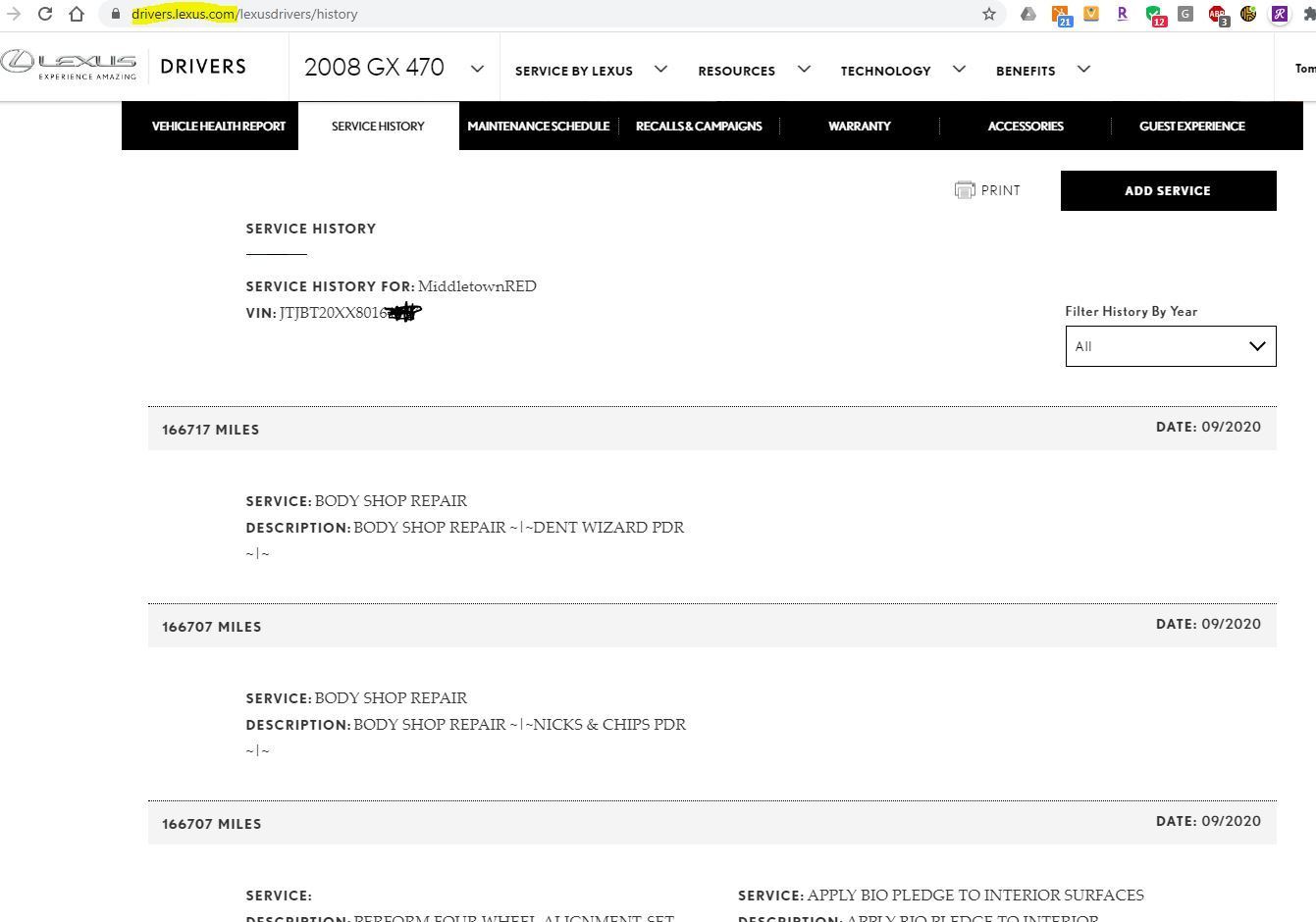

You can also sign up on the Lexus site. Once signed in, you simply add the VIN to your stable. Once in, you can see all Lexus dealer service history records. Here was mine:
