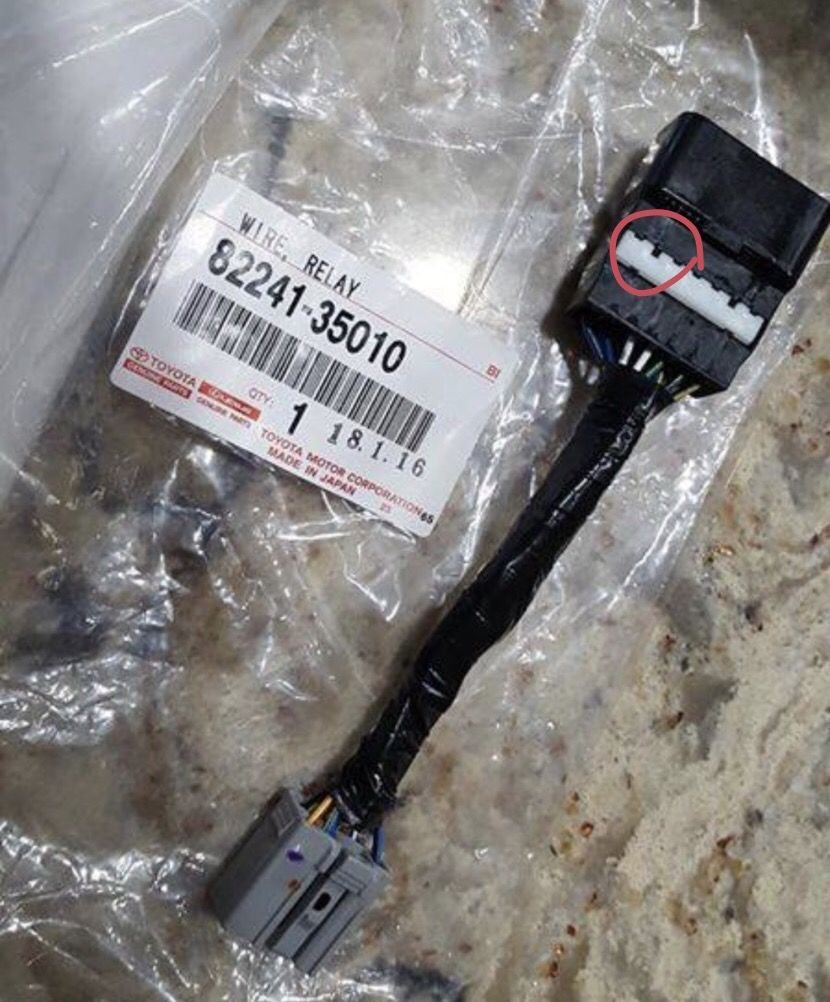

Bummer!!! I installed what was supposed to be CANBUS LEDs originally but they didn’t work...hoped you’d have better luck.
Anyway. Here’s a reference pic. I’ve circled the pin location below. You need to move pin 10 to 11. Use a small needle nose plier to gently pull the white strip off of the connector. Then carefully pull back a few rows then with great hand dexterity (LOL) use an x-acto knife or small blade and lift up the locking tab holding the wire and pull out the wire. My hands are large and I’ve lost a bit of dexterity so it took a while for me. Lots of profanity uttered that day. Haha.
FYI Pin 10 is a white wire if that helps.
