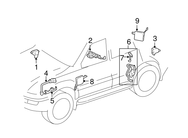

Check the ride height sensors. There's one on each side, ahead of the rear wheel.
#6:
https://www.mylparts.com/oem-parts/l...QtN2wtdjgtZ2Fz
https://dz310nzuyimx0.cloudfront.net...b0297fb031.png

I just came in from putting it up on my lift. I found a bracket on the passenger side ride height sensor was completely sheared in half. The sensor was hanging way down low. I put it back up to where it should be and the back came down. I just ordered 2 new sensors
