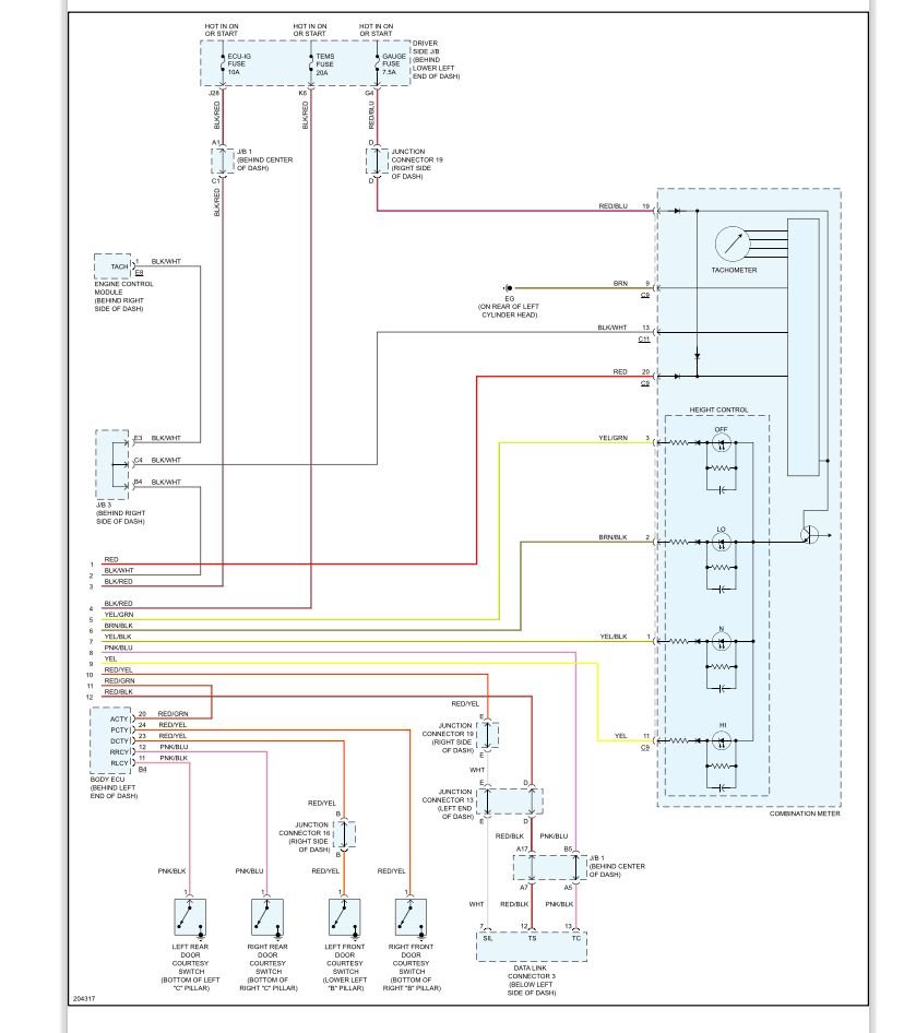

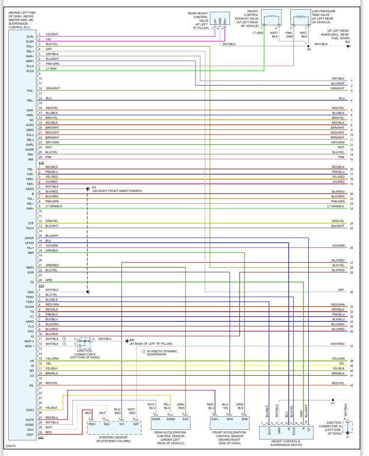

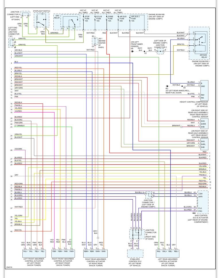

Hi,
Has anyone been able to bypass the rear level sensors and use the compressor switch as a manual switch to put air in to the rear leveling air bags?
My leveling sensors are no longer functioning properly so I'd like to be able to manually use the H-N-L switch to turn on and off the air compressor to manually fill the air bags. If someone knows how to do this or has the wiring diagram for it that would be a tremendous help!

Sorry ive been so out of the loop. Let me pull the diagram and see. I’m sure it can be done... but I’m not so sure it would hold up. Since it doesn’t hold up under normal use. Lol
but I’ll look into it.

@MrJason - This is extremely helpful!! I can't thank you enough. The bags will hold once I pull the fuse and relay to the compressor. It's been holding for a month now. I just need to get more air in to the bags now and get the GX to a comfortable ride height then pull the fuse and relay again.
Thanks so much!!
