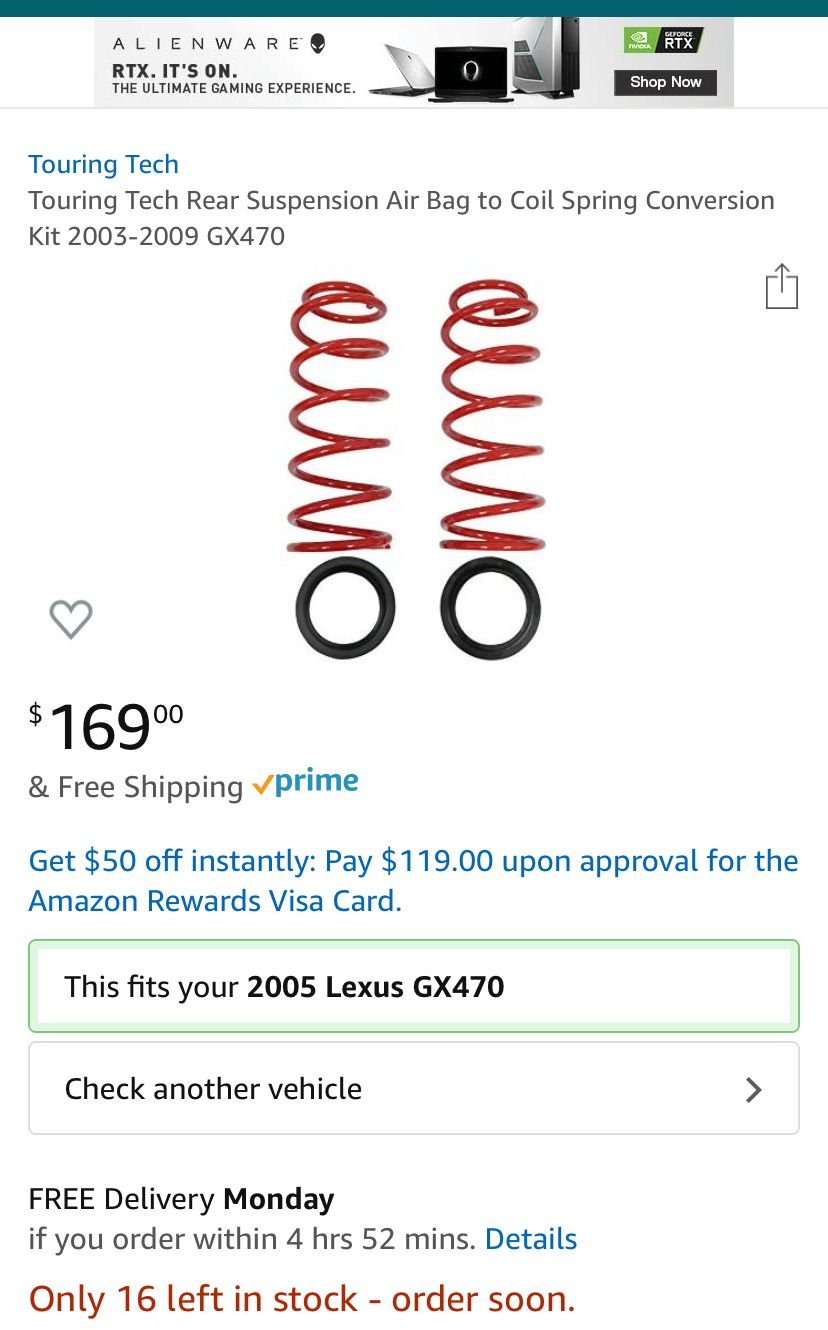

after looking again... Kodak is right. That is a height sensor and bracket.
Looks like Ike you will need that conversion. If it’s just an old beater that you are gonna drive to work and back.
Put the $169 amazon conversion kit for rear coils. It’ll hold it at the standard “normal” height.

With or won’t shocks...
