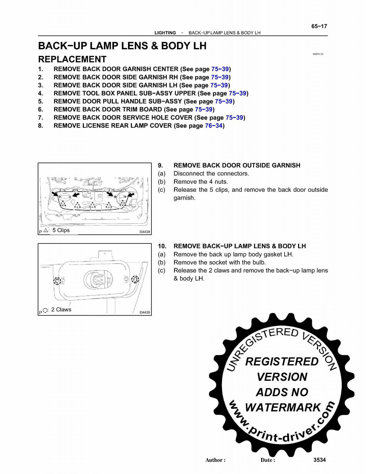

Old Dec 15, 2008 | 04:24 PM
cmarshack's Avatar
cmarshack
Joined: Sep 2006
Posts: 477
Here you go...

Thanks...I think.
What the hell is a Garnish? I mean I know what the word means, but in this context is it referring to the outside chrome trim piece above the license plate?

Originally Posted by bobinsofla
In the link in the first reply to my post, there are two members who claim that you can remove the light housing from outside. but I still can't see how to do this (easily).
If you look at this last picture you can see the two "claws" that hold the lens in place...I am asssuming that you can carefully pry this out from the outside (insert disclaimer: If you brake yours don't come asking for me to help you replace it...do it at your own risk).

I think I'll do it the long (right) way. I just don't see an easy way to do it from the outside without, breaking, scratching, or screwing something up....
