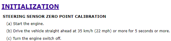

Drive straight ahead at 22 mph (or more) for 5 seconds. That's the initialization for the steering zero point. There isn't really anything else unless you have the trunk open when you remove power.
Oh geez, so if I'm reading this correctly, you're telling me to drive the car at 22 mph for 5 seconds and not to break or put it in park, but just to push the button to turn the car off?
Ok, I guess you're only old when you're afraid to try something new.
How does the car react when you do that so I know what to expect? I wish you were in IL.

What happens when you just suddenly turn a car off like that? Does it jerk, etc? I'm definitely not the racer here.
To me, this sounds like you're callibrating the accuracy of it, but that's not my problem.

No, I seriously doubt they expect the tech to shut the car off like that. I'm pretty confident all you need to do for this exercise is drive straight for 5 seconds and shut down normally.
