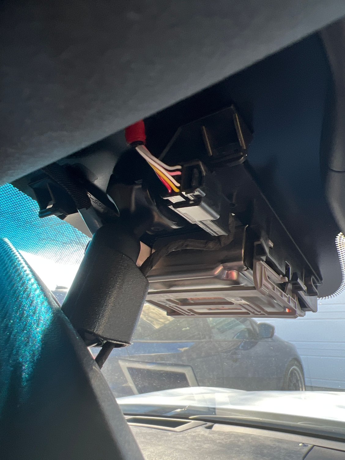

Anyone have a wiring diagram for a rear view mirror for 2016 Lexus GS F? Can’t find anything online.
gray, pink, white, yellow, red.

Yellow is switched power (IGN).
Red is battery (always on B+)
White/Black is ground (almost always on anything Toyota)
Gray is EC- for autodimming
Pink is EC+ for autodimming.

I am testing with my meter and if I put my black tester into the white wire and my red tester on the yellow wire I am not getting anything registered with the car on or off? I am however getting power if I put my black tester on the white wire and and my red tester on the on the red wire??? If I hook it up to this the dector will always be on. Can anyone help?????

Yellow turns on when the ignition is on. Not ACC, but ON. Engine doesn't have to be running, but it takes a double press on the switch to get to ON. If you are not seeing battery voltage on the yellow wire with the ignition switched on, there is something else wrong.
Black is negative on your meter and ground (negative) on the car. Red is positive, and seeing battery voltage on the red wire across the white wire with the black stripe is expected.

thank you! Got it all hooked up this evening. I really appreciate you help! This board is great!
