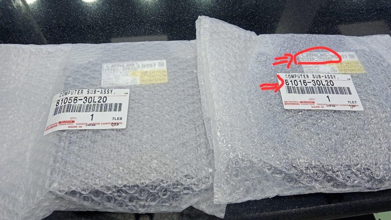

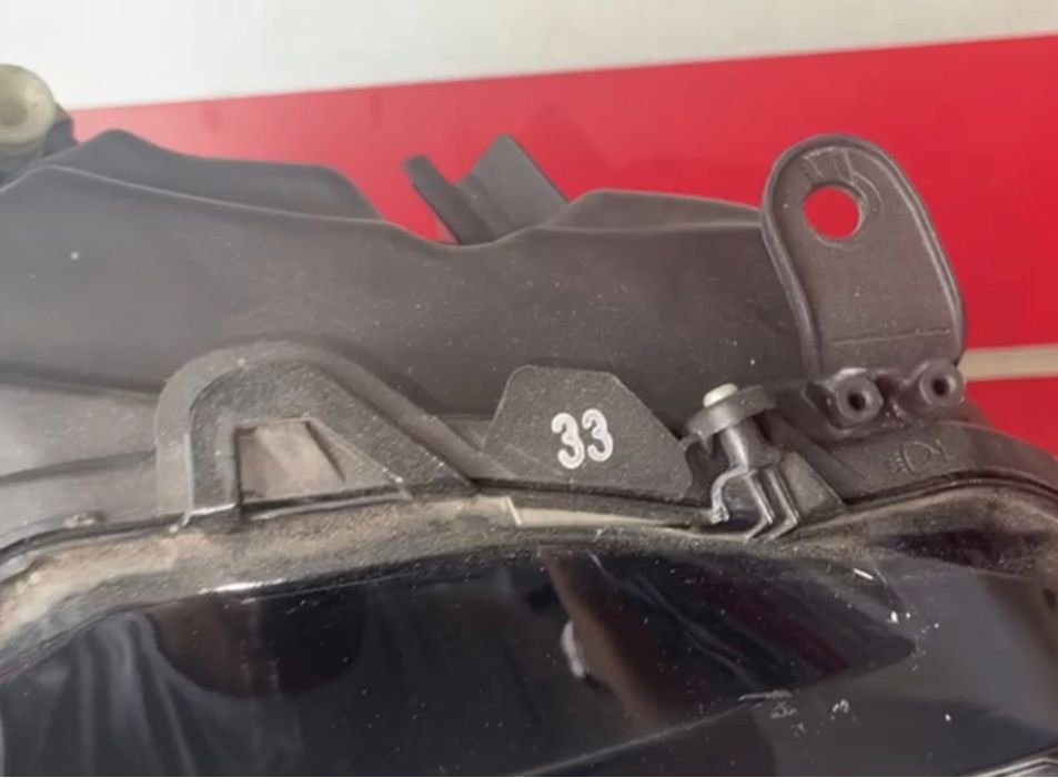

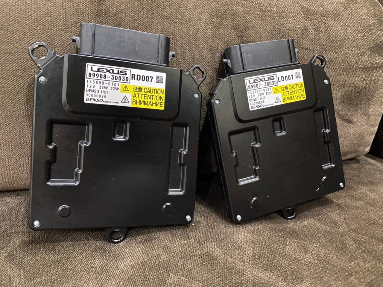

Thank you for the replay !
I got them used and the problem Lexus is not mentioning the part number on the headlight unit so we code check for which market is it.
i will attach some photo which may help to identify

My parts reference doesn't find the part numbers for the controllers anywhere globally, but it would seem they might be for Middle East market since Google shows results from China and the Middle East. Very strange I get nothing at all from the resource I use for part numbers.

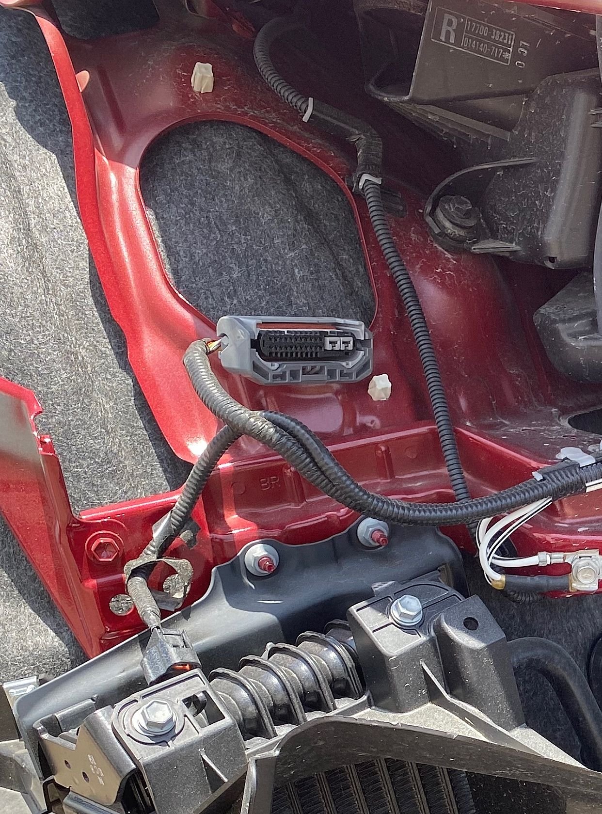

The GS350 has this Module on the Drivers side floor side panel.
https://www.clublexus.com/forums/ls-...-messages.html
Someone had the problem you have in the GS350 forum. They had the 2 control units you posted connected backwards. I see a L & R on the parts. Try reversing's them if you have a RHD, or even if you do not.
