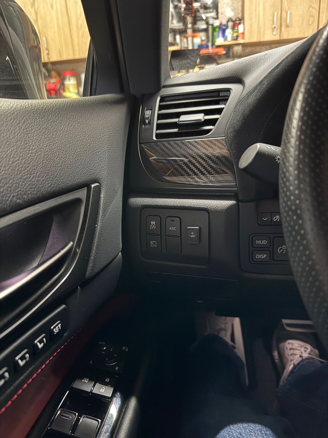

Since this thread was resurrected, I will post a button mounting location update. For those wanting an accessible location and dont mind a little modification, check this out:
On my car, this button module was hollow on the right (empty side). I made a hole just large enough to fit the button wire then stuck on the button to the front. This is what it looks like:
For those interested in doing this, this module is held in by 2 metal clips on each side and from my experience, they needed to be squeezed from behind to get the module out. I popped out the panels on the left side of the dash to squeeze in behind it.

That looks really good. Was there a reason you didn't use the existing blank in the bottom right? And how did you end up doing the camera mounting bracket? Did you drill and tap somewhere for a bolt or did you find an existing location to mount to?
That blank on the bottom right, is not really a blank. Its a double switch that happens to be used for a single switch. Not sure why Lexus didnt just pop a full sized switch in there.
Camera mounting leaves alot of room for creativity. I essentially did the same mounting as Bullets Garage:
