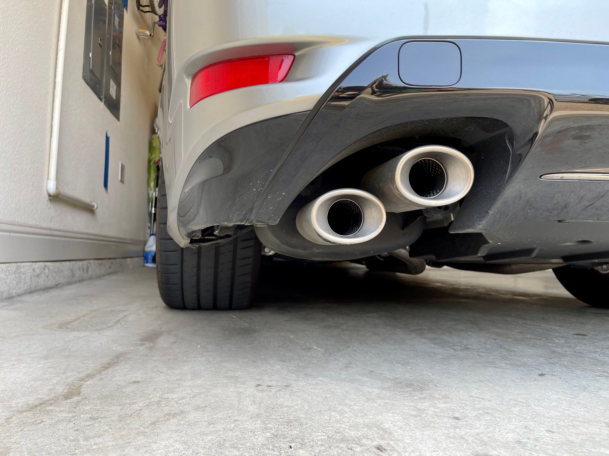

Hi all,
It was dark and I was careless and backed the car a bit too far and barely scraped the underside of the diffuser (near the exhaust tip) and the lower of the 2 stacked exhaust tips. What would you do? Let it go since is it only a cosmetic issue that can only be seen underneath the car or at least try to polish the scratch on the bottom of the exhaust tip? What would you polish the stainless steel tip with? Thanks for any input.

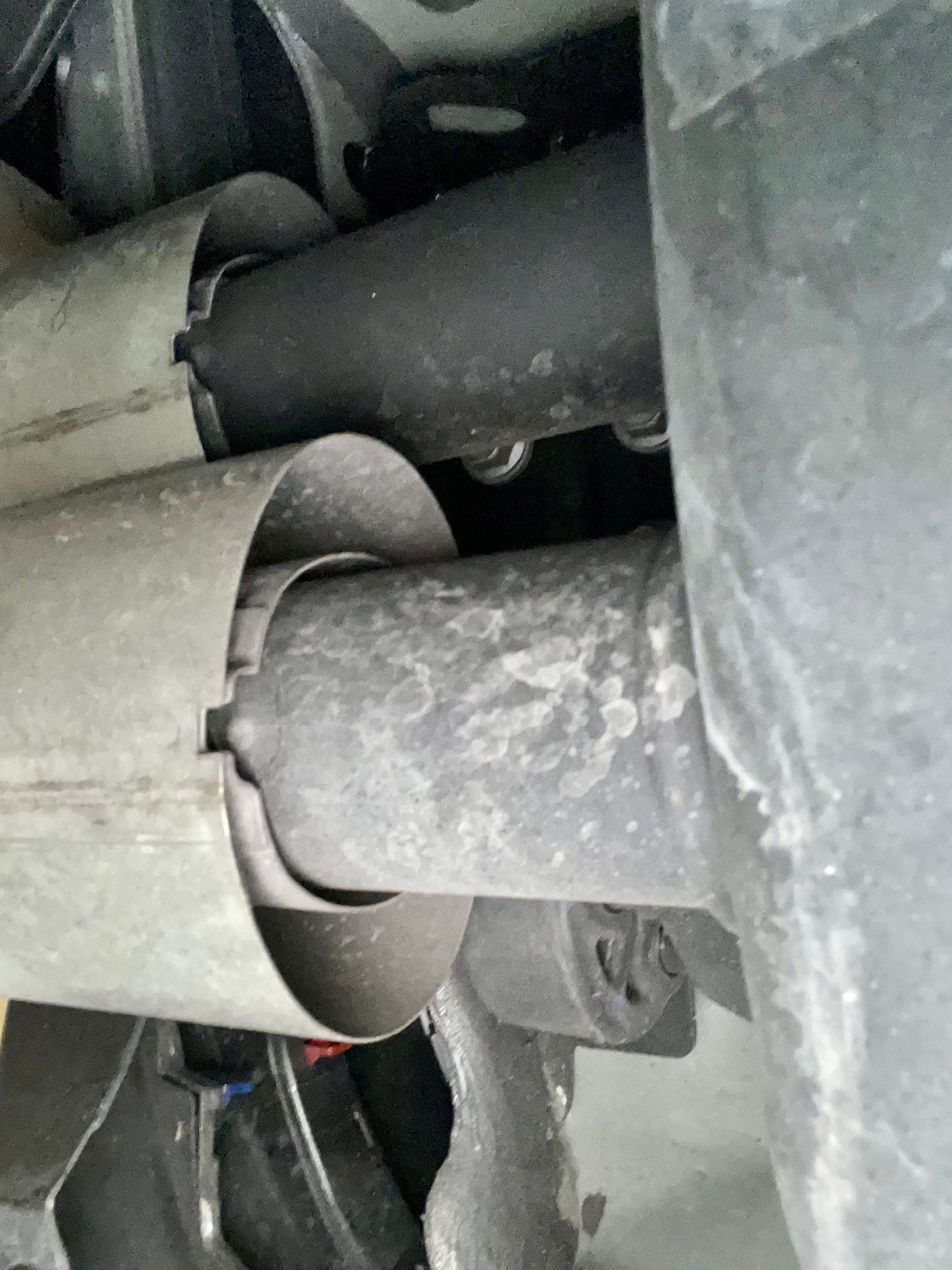

Personally, I think the OEM GSF exhaust sounds amazing.
The OEM tips are clamped on and can be removed.
You can replace the tips with any after-market tips you like. There are a few on eBay ranging from 3" to 4"

I used both medium and fine brass wool, combined with a stainless steal cleaner / brasso combination. Tips came out great.

I see now how the tips are clamped on. Good to know!
