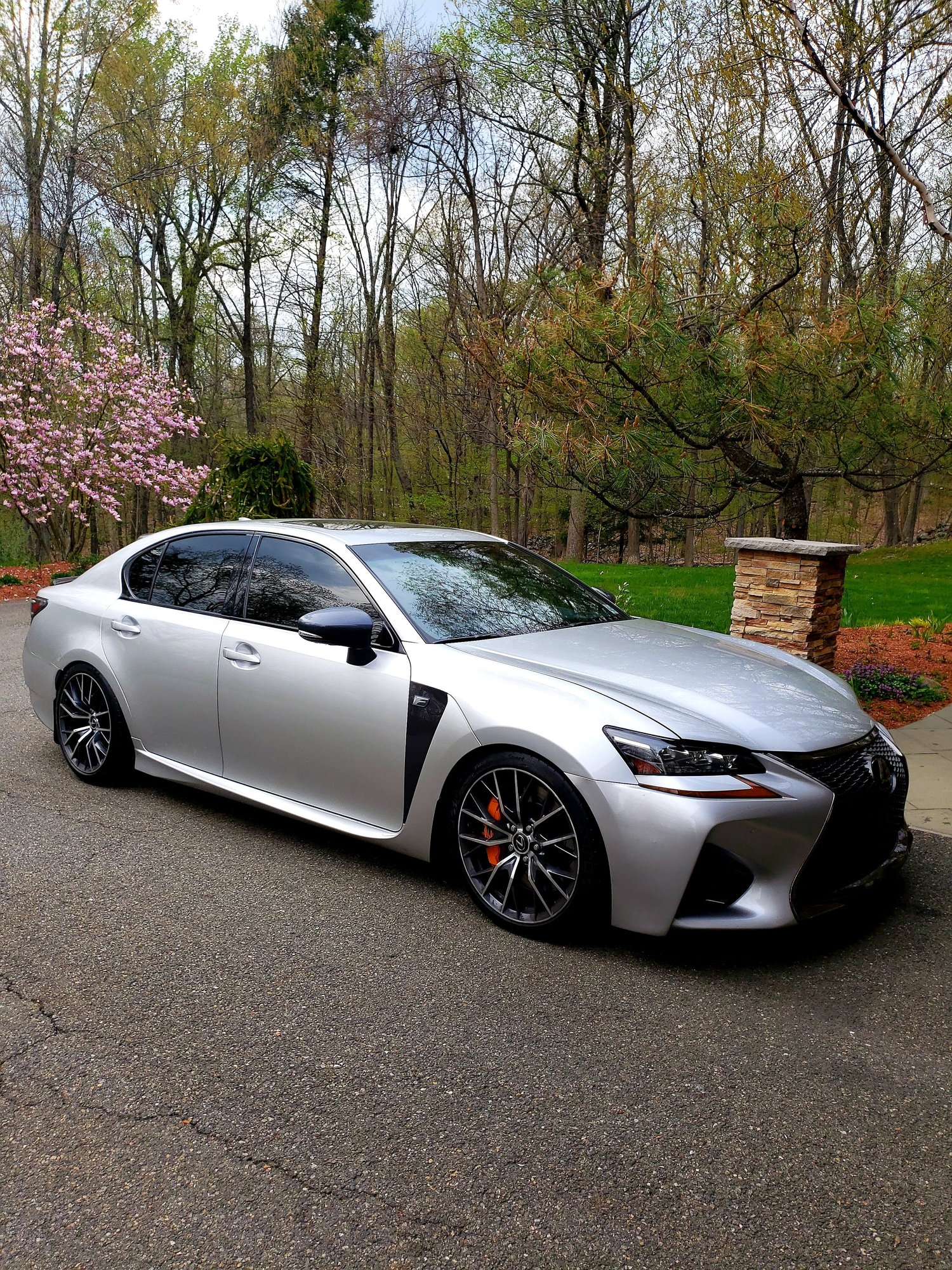

Installed RR racing road and track coilovers and LCA bushings. One hour and twenty minute ride home and nothing but smiles. 100% better. Steering response is on point. Ride firmer yet planted and supple. Less Jarring, more confident. Braking is concise w zero nose dive. I could go on and on. Just sharing. And I should've done this sooner.

Thanks Steve. I did not do the install. I had a rusted / frozen rear lower shock bolt and wasn't comfortable heating that up for removal to install the coilovers so I took it to a guy. I hung out while he did the work. It's very straightforward. Only suggestions if any are the obvious ones. Remove the surrounding support braces to allow for easier access.
You'll be happy to have them installed. Significant improvement.
