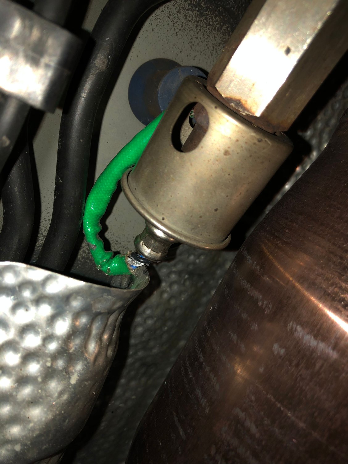

Well it turned out to be the 02 sensor wire was rubbing against the heat shield. The reason why it only shorted when in sport+ mode or under hard acceleration and not when cruising on the highway must’ve been the vibration of the exhaust. The wire has been repaired and untangled and the heat shield slightly bent back to prevent contact with the wire.
