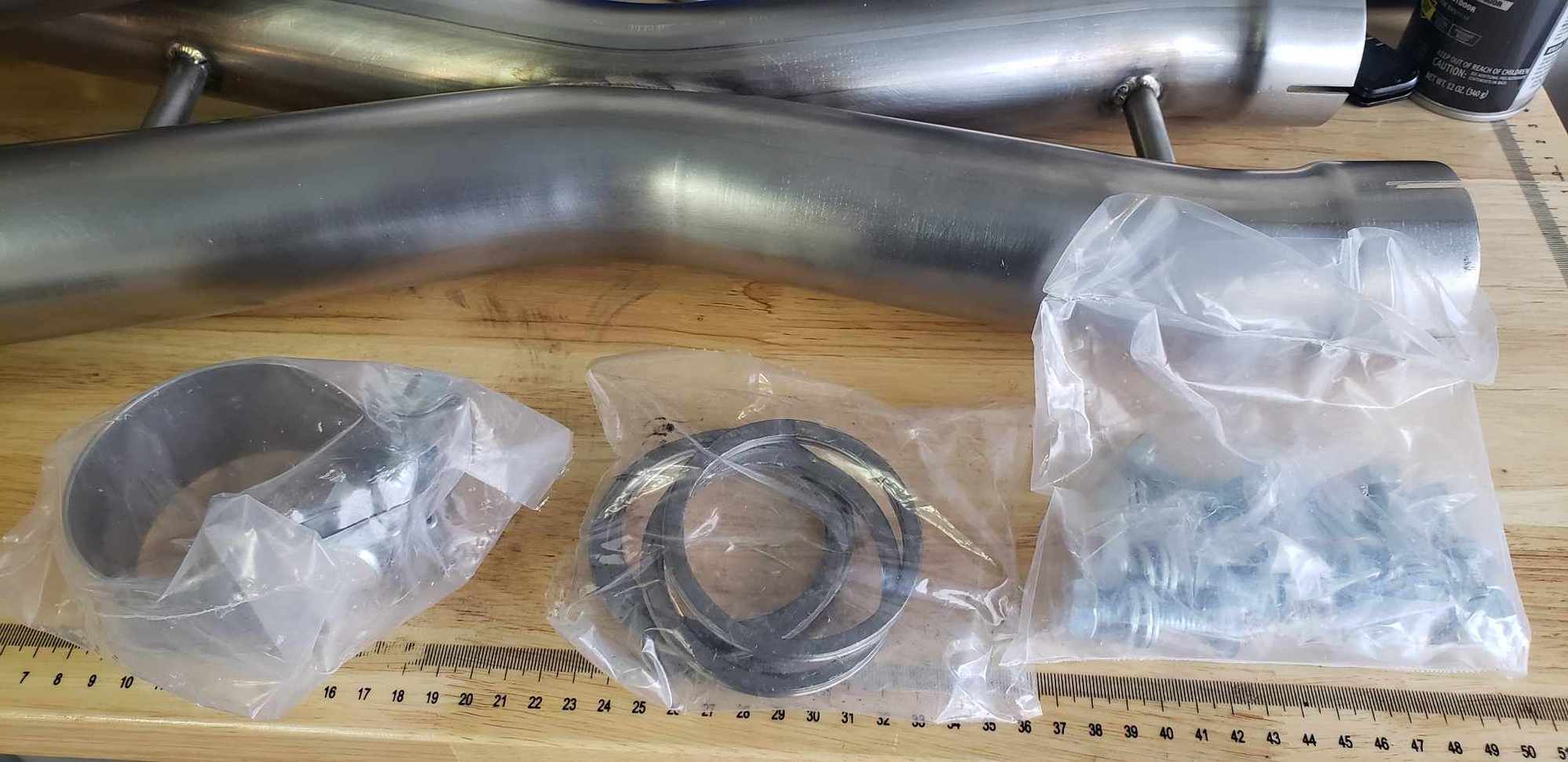

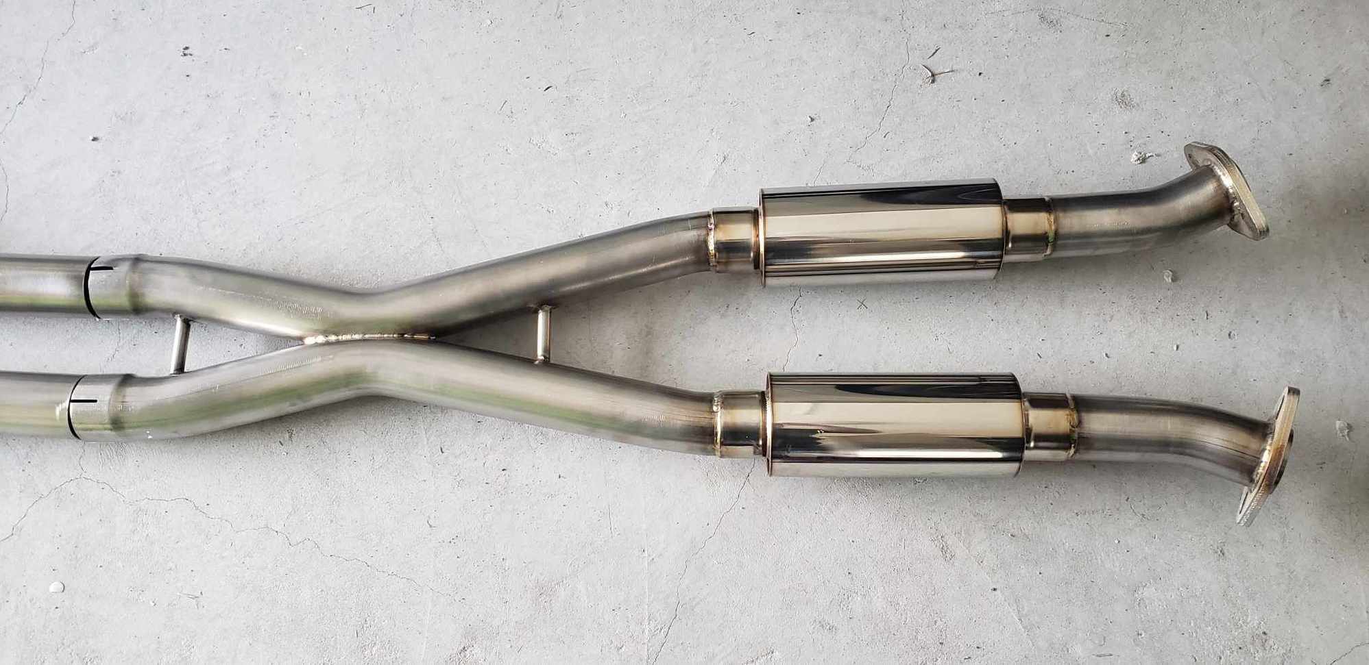

I was ecstatic to hear UPS was dropping this off today, I even came home from work for lunch to take some pics!
Purchased the PPE Engineering 2.5" midpipe (X-pipe) from them direct. Opted for catless with resonators. Comes with hardware and I also got gaskets from them as well.
Tig welded 304SS. Quality is top notch!
Haven't seen any videos or pics for that matter from people using this particular midpipe. Guess they used to make an H pipe version as well. So this would be the new version PPE is producing.
This should match up nicely to my current Revel Medallion Axle back, and stock headers for now.
These are build to order and I bought them December 29th and they arrived today. So around 7 weeks ish.
The resonators look to be either built in-house or Vibrant. Either way is good because I've used Vibrant exhaust parts on all my vehicles over the years.
I'll be installing very soon!

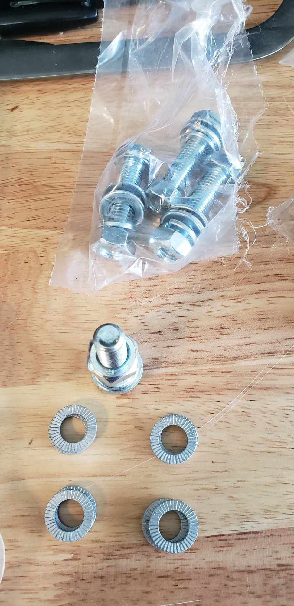

I had some left over Nordlock (wedge locking)washers that I used on a previous vehicle's exhaust parts. Got them from Mccmaster Carr. These are great for high vibration areas, as they use tension vs friction. Gonna try them out on the header to midpipe connection.

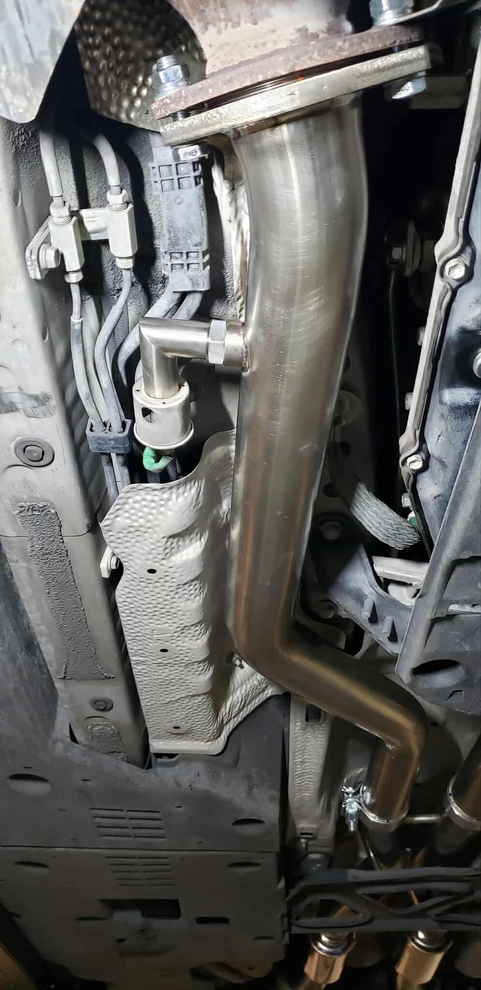

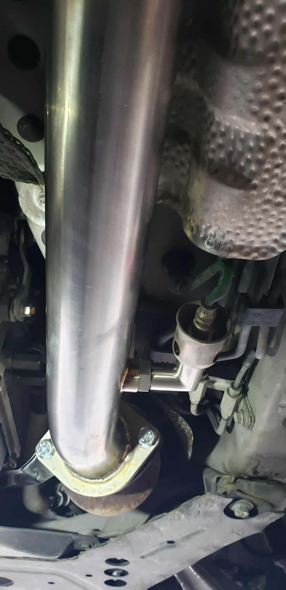

Some pictures of the PPE Resonated midpipe (X-pipe) install.

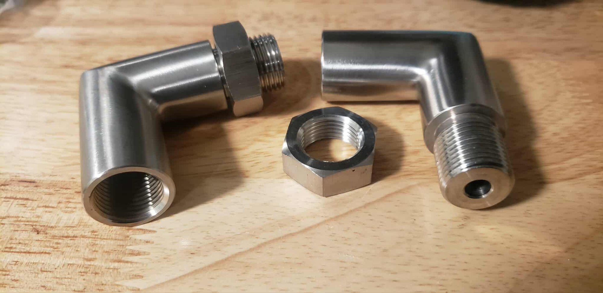

I also purchased Big Daddies Garage 90* angled 02 simulators to prevent CEL. Have used these in the past without issue, they are 304SS and less than $60 for the pair shipped. Zero CEL codes either and i've put about 600 miles on this setup so far. No leaks either.
The PPE midpipe is excellent quality overall. I had some reservations about installing with the Revel Medallion axle back, and stock manifolds since I haven't seen anyone post pics or vids with this particular setup yet and was a little concerned about fitmet to the Revel (Tanabe) medallion axle back.
The main issue I ran into was at the rear connection to the Revel Axle back, the fitment was extremely tight in which i'm glad the PPE midpipe flanges had some minor slotting built in to bolt up the hardware. So, the supplied hardware with the PPE is correct diameter, it just wasn't quite long enough to get atleast 3 threads exposed past the nuts/washers. I couldn't re use the factory spring style hardware either. No big deal, just a quick trip to ACE hardware and got longer bolts with same thread pitch.
Also, the PPE midpipe rear section doesn't allow re-use of the OEM style donut style gaskets, however I had purchased the OEM style flat gaskets that are recommended for this midpipe, (came with 4).
I also applied Permatex Ultra Copper 81878 on both the front and rear flanges for peace of mind.
Lastly, the black frame brace that crosses over the X pipe section required some spacing to clear because if the exhaust moved it would make contact. I used some spare M10 washers I had, which gave about 1/8th extra clearance. So far so good and no rubbing.
There was some trial and error getting it all lined up, and securing everything in place, making sure nothing made contact. But it all sealed up and sounds so good now.
Overall I'm very pleased with how it all turned out, and the PPE X pipe and Revel axleback is the closest setup I could find for the price and convenience like the old JOEZ/PTS design.
With 600 miles on the setup so far, No leaks, and no CEL.

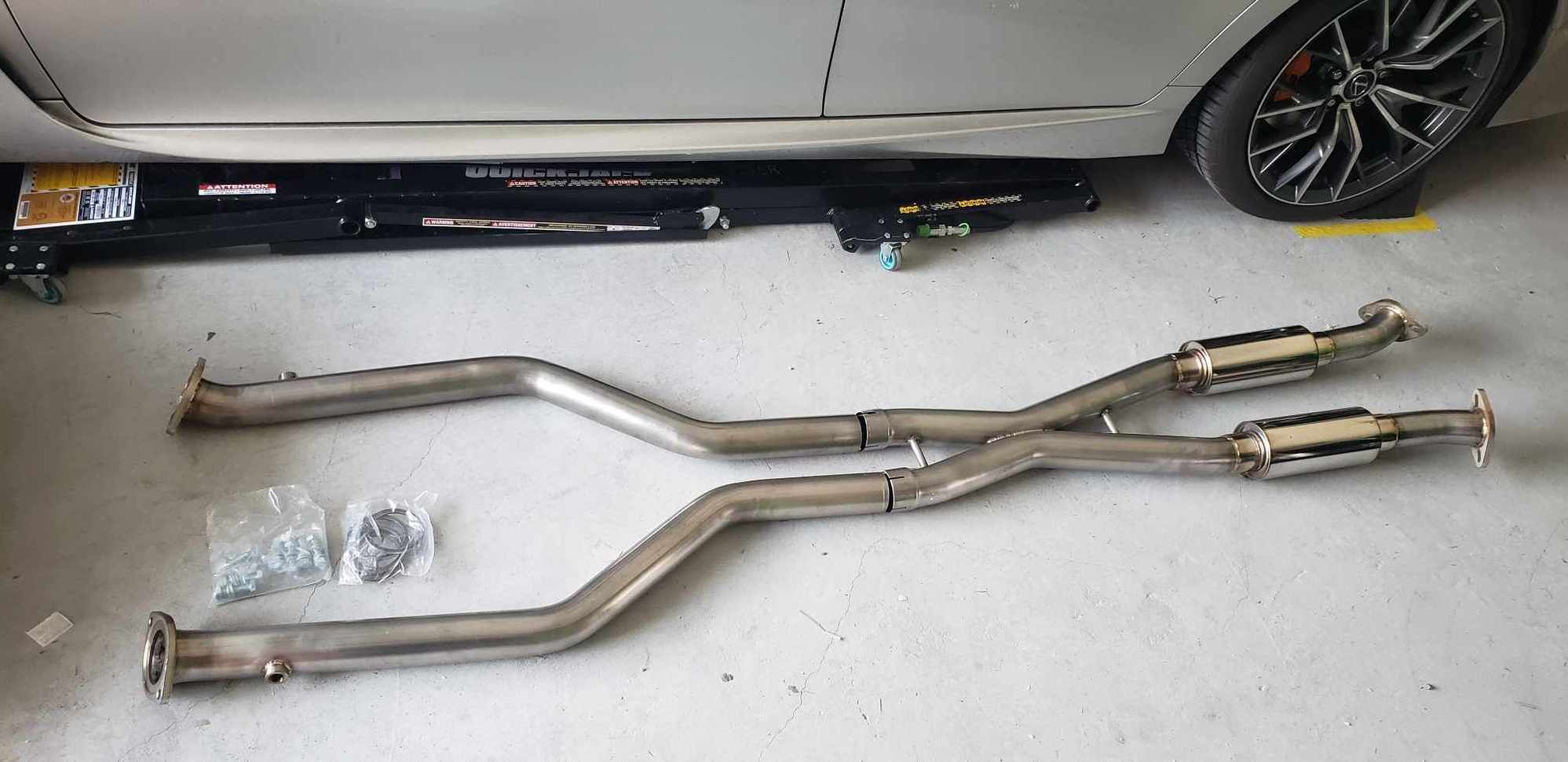

Some additional random photos of the removal/installation. As well as hardware, 02 sims, and RTV. Hopefully the pictures answer most of the questions.
GSF OEM Midpipe VS PPE Resonated X pipe

BIG DADDIES GARAGE Angled CEL Fix (o2 simulators) 304SS, (not zinc plated).
BigDaddies Angled CEL Fix (o2 sims)
M10x1.25 30mm length hardware
