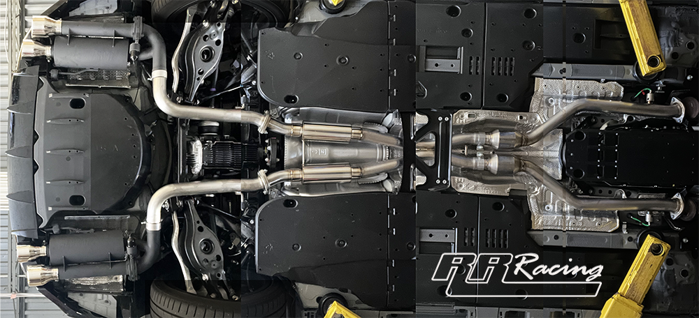

yessir I love the thing . The previous owner sent me a post of people discussing that kind of install on a ISF, but I can't seem to find it for the GSF or RCF. Any pictures would be really helpful.

Post # 7
https://www.clublexus.com/forums/gs-...questions.html
Also a pic from RR that shows installed.

Yup, but the problem with that set up is they're going to fail me for only have secondary cats instead of primaries and also the O2 sensors are both ahead of the cats which means fails..
