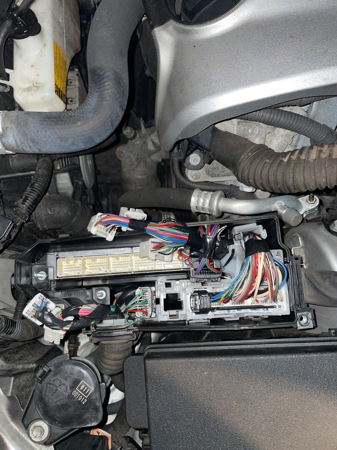

Hello all,
really struggling with removing the ECU right now. Can’t for the life of me seem to remove the Junction at the top that blocks my ability to unscrew the other side of ECU. Any ideas?

Originally Posted by 14GS350
Hello all,
It took me a long time to figure out how to remove that damn clip & after numerous hours I found some CL/ tutorial vids on it.
On the side of that clear clip towards the engine, you need to jam a flat nose screwdriver or something to unhook the clear piece from the housing it is attached to. It’s a massive pain man. I’ll try to find the resources I used which may be able to better describe it

https://www.clublexus.com/forums/is-...moval-diy.html
@14GS350 This was the thread I followed. Hope this helps you. ECU failed?

This one's from 2IS forum. 350, same engine same layout.
So that clip your talking about has been giving me extensive trouble. I tried jamming it with a flat head and that has only resulted in the clip slowly chipping. I'll send more pictures tomorrow, but I'm referring to the black clip to the right of the wire junction, to the right of the white plastic one. Is this the correct clip I need to get to access the ECU?
