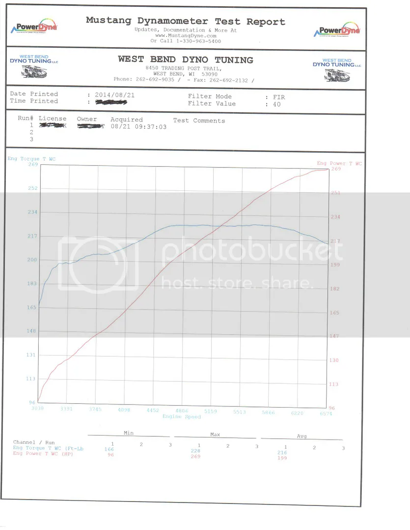

You say its minimum at 30%. 30% torque lets say is 1 third of car’s power. That would be 100hp to the front wheels. Something like a golf 3 hatchback. That’s enough to shoot the snow as high as the rear wheels. When its disabled it’s disabled. There isn’t even one asthmatic half dead horse to the front wheels, they are barely rolling along.
At full throttle below 4000rpm, even if the rear tires are spinning, with a nominal 30:70 split the fronts may only be receiving approximately 60 lbs/ft of torque, which is less torque than I use to secure my lug nuts and not guaranteed to spin a tire bearing a 1000lbs load, even on snow.
