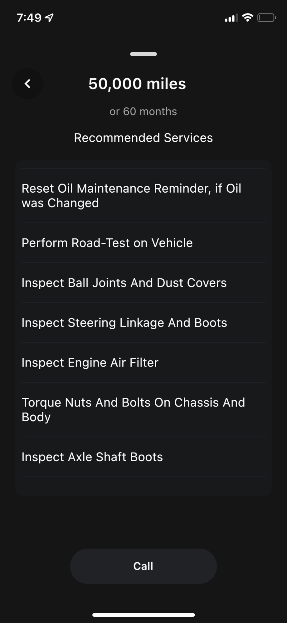

Just got a notification to do all of this at 50k, should I do it all or are there something’s that I can do myself?

90% of those times are "inspections"
The only real things you need to do are:
Replace Engine Oil and Oil Filter
Rotate Tires (if AWD)
Replace Cabin Air Filter (that's your personal preference and/or if you notice any mildew type smell)
EFI Fuel Tank Additive -> I personally use Seafoam when filling up my gas tank every oil change. No real particular schedule, just as I remember.

okay I kinda was thinking the same with all of the inspections! I’ll lookup the additive! Thank you so much

Honestly just air filters and oil change. I've never used an additive, but seafoam is overkill. I change wiper blades once a year, you can buy just the rubber for $8-12 each from an online lexus dealer and retain the oem wiper blades.

EFI Fuel Additive is just a money maker for the dealer. If you really have something blocked up, a bottle won’t do much. There are already additives in fuel to clean your fuel system.
