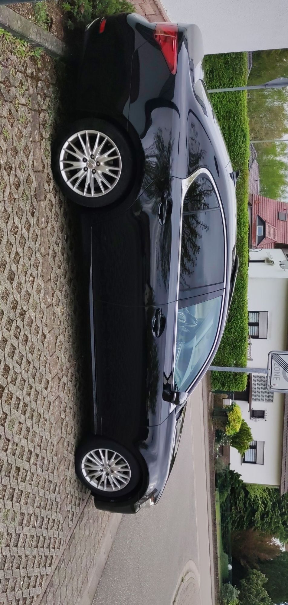

Hi folks, I have 2013 RWD BASE GS and I want to get some new wheels for it. I'm currently looking to get 20x8.5 +35mm 245/20/35 +40mm front and 20x10 275/20/30 in the rear. I was just wanting to get some feedback on my fitment choice before I actually order them. Will this run ok without any rubbing or anything? Also do you guys think I'll need to lower to keep it from looking like a 4x4 lol.
These are the wheels:
current car has OEM 18x8 235/45/18:

When you move up to 20's, i think it will look a bit tall - but since its RWD, it might not look terrible as RWD GS's sit a tad lower than AWD. Recent helpful thread on lowering to give you a sense of height differences: https://www.clublexus.com/forums/gs-...per-downs.html

I have the same stock wheels, just refinished in PVC Black chrome:
