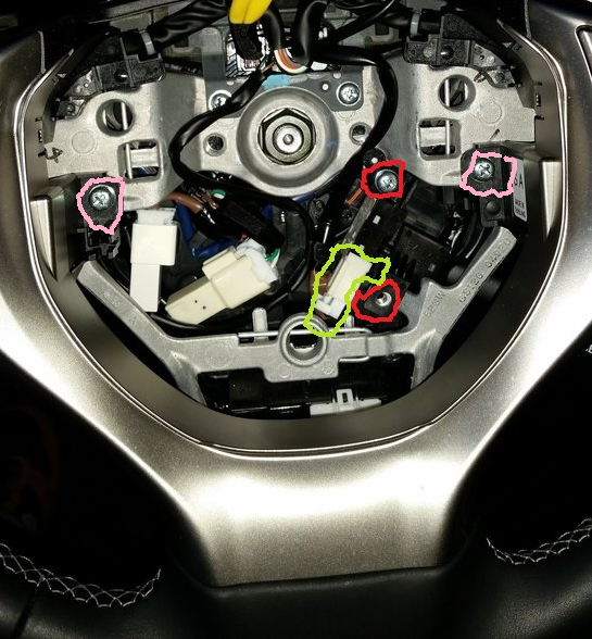

All you have to do is remove the airbag. Then remove screws holding the silver trim piece. Then you have access to the plug and 2 screws that hold the cruise control switch in place.
DIY steering wheel airbag removal:
https://www.clublexus.com/forums/gs-...el-w-pics.html
You can buy a new switch online from a lexus dealer like mylparts.com for $115 or just get a used on on eBay for $30. It's a 30 minute job, 15 minutes for the dealer mechanic, but they like to bill 2-3 hours.
You can see below a pic with the airbag removed. In pink is the screws you remove on the silver trim piece. Red is the two screws that hold the cruise control switch, green is the plug for the cruise control switch.
This is all assuming the switch is the problem and not something else. A scan with Techstream will tell you were the fault lies.
