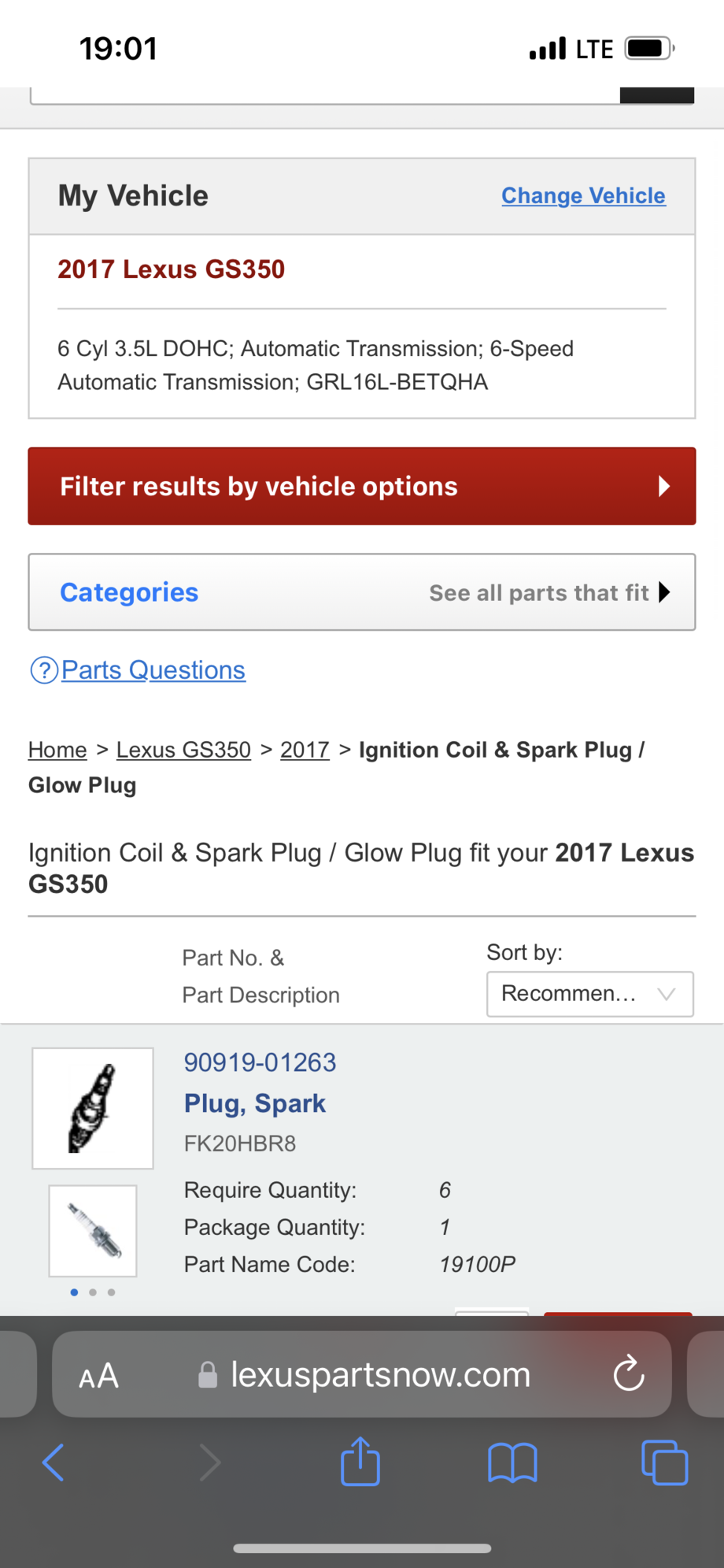

Can someone cofirm the exact part number for the Lexus Spark Plugs; I see two numbers on the Lexus dealer website
9091901263
9091901249
Which is the correct one? Also, how many does this car take? I assume it's one for each cylinder , so need to get 6 in total, correct?

Originally Posted by VA75067
Bumping this up..
Six Plugs
As for the correct one, I know Denso markets an aftermarket TT type plug (9091901249), and the other Part number is OEM what they use in the factory. Both have that second contact point on the ground electrode.
Both are excellent and interchangeable. Rockauto lists 2 Denso Plugs:
https://www.rockauto.com/en/catalog/...park+plug,7212
Specs are very slightly different. Nominal gap, and the finewire diameter.

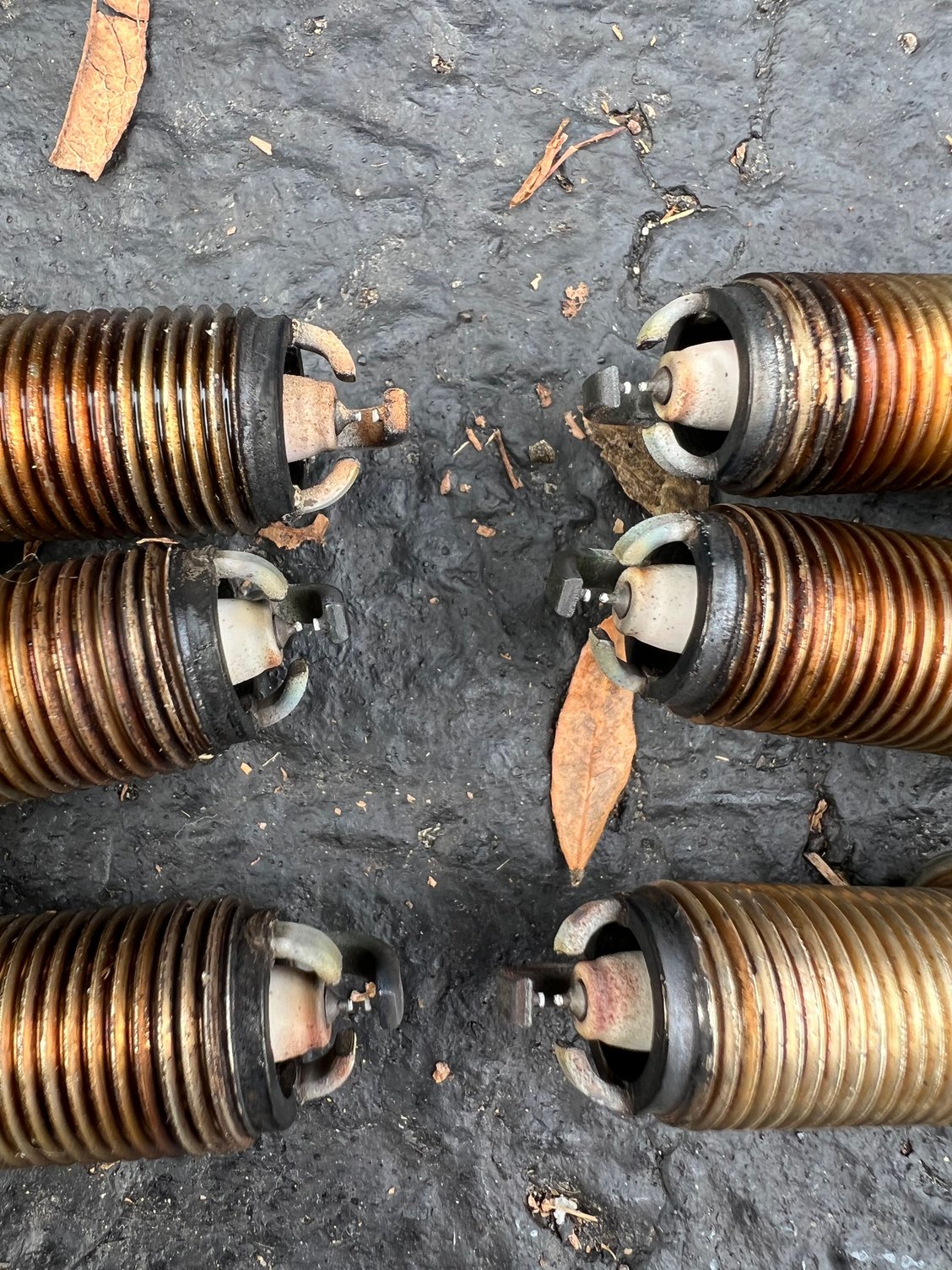

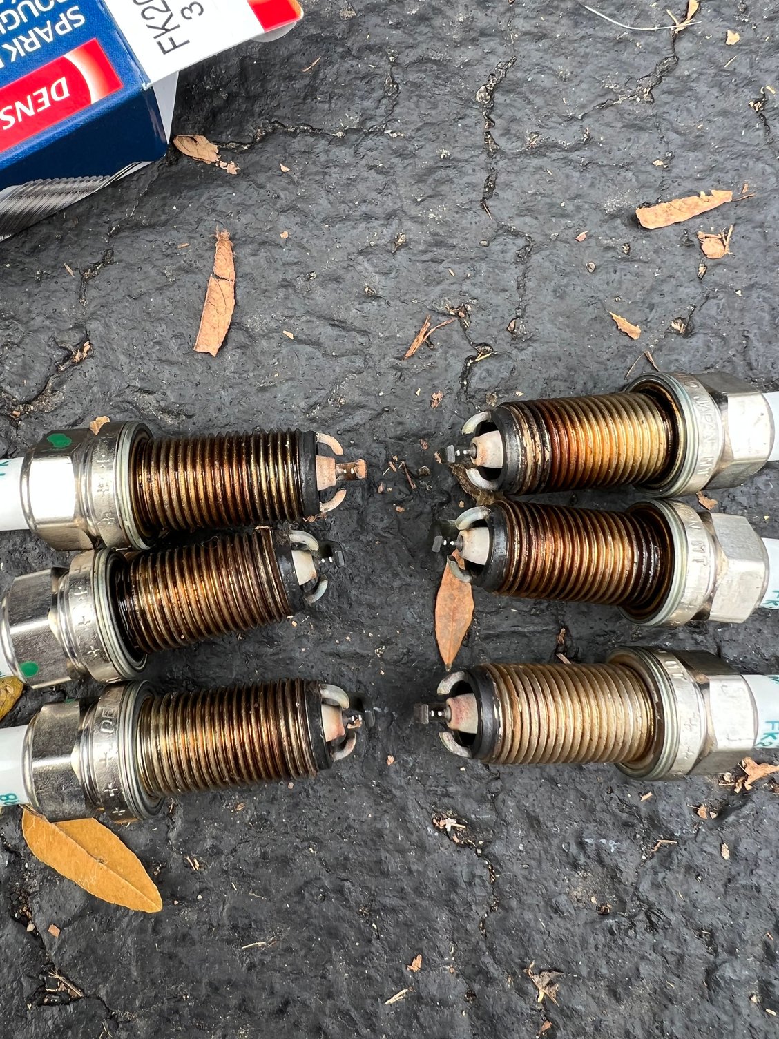

this is how they looked at 100k miles. 2017 gs 350 f awd

here are the part numbers. Before facelift the v6 was 2 gr fse. After facelift 2 gr fks.
Those look like they were ran a week, not 5 years and 100K miles! The insulators is clean and the electrodes are in excellent shape. I would not be afraid to run those another 50K easy.
My dad said the same thing when I showed him the picture. also did the transmission drain and fill at 100k and fluid was still red in color when it was draining. Did this to see the health of the engine and transmission. Pleased with the GS.
Perfect! Those plugs are good for another 150k miles with no deterioration in performance or fuel mileage.
