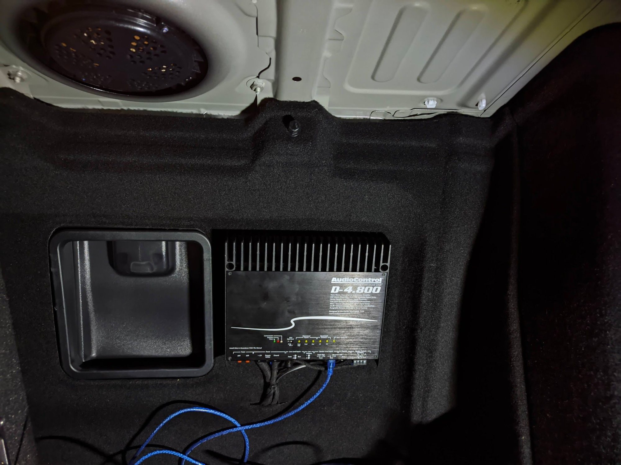

I replaced the rear decklid subwoofer today. By replace I mean just having the installer cut off the sub completely and rerouting the subwoofer to an external amp. I briefly had a chance to ask him about replacing all the speakers+amp and he mentioned it was possible (he did it on his GS with ML also). He routed all the speakers from the ML amp output to a high level converter and ran wire to all the speakers from an external amp.
The setup:
Audiocontrol D.4800 Amp running bridged 400W @ 4ohm. Has room for a 2nd sub with the same power if needed. It's a bit overkill for this application but I had it laying around from a previous install and having DSP is nice to tune the subwoofer to the cabin. Will post RTA signal info as soon as I find out where the hell my mic went.
Audiocontrol ACR-3 level controller
Morel Primo 104 Subwoofer (Using manufacturer recommended vented enclosure specs ~1.1 cubic feet)
