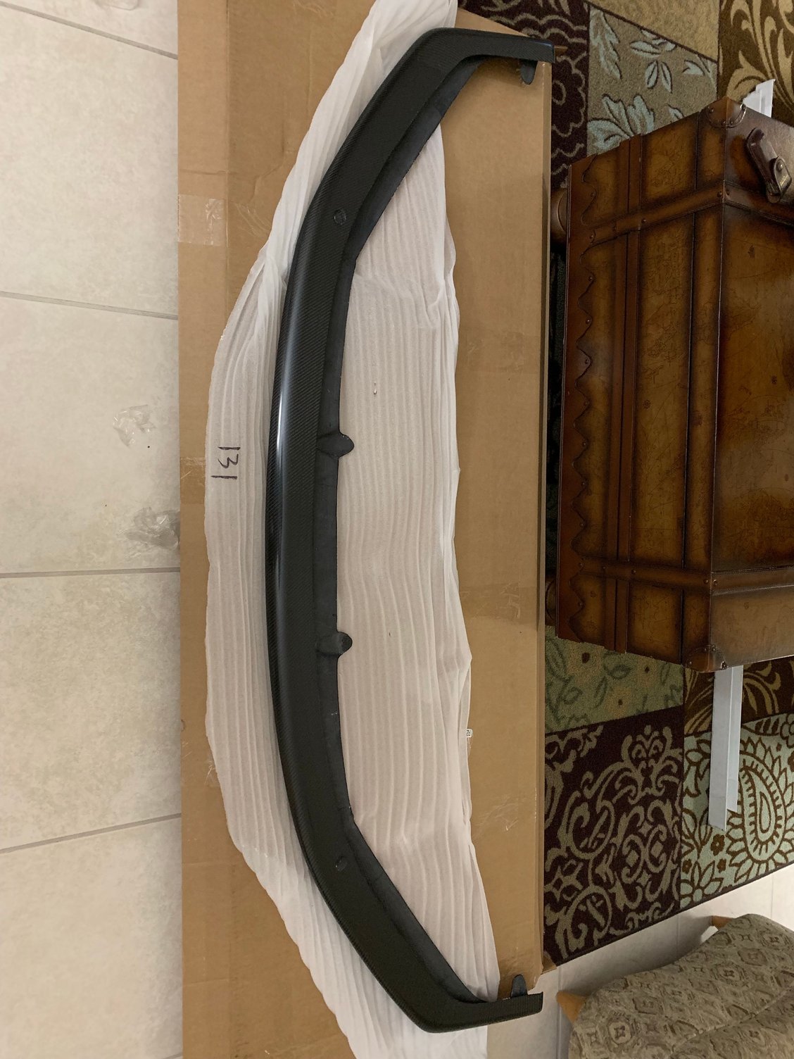

So I finally pulled the trigger and purchased the eBay replica Lexon lip, I have seen many horror stories on how these came packaged but I must say this seller out did them selves with the packaging. The lip was surrounded by expanding foam in the box. I plan to put this on soon but have some questions for all that have installed this lip. Did you all just use the 4 mounting tabs and OEM locations to bolt the lip or did you also add self tapping screws in other locations or any 3M tape? Also was thinking of having the lip covered in 3M or Xpel paint protection film to avoid any chips from road dirt..Have any of you done this?

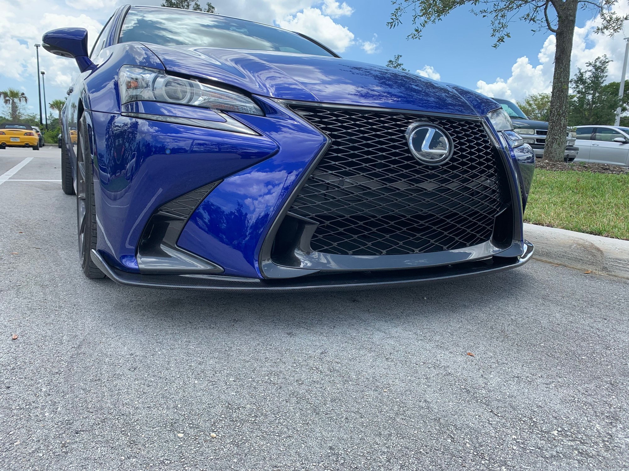

Installed the lip, fitment was perfect no issues at all. I would suggest having the car up on a lift to make the install easier. The lip has dimples for the drill locations. The 2 outer locations as @jlai20 marked use the factory bolts, also the 2 middle point use the factory bolts. The 3rd marked locations from the outsides I used plastic rivets and I also added a set of plastic rivets to the center locations.
