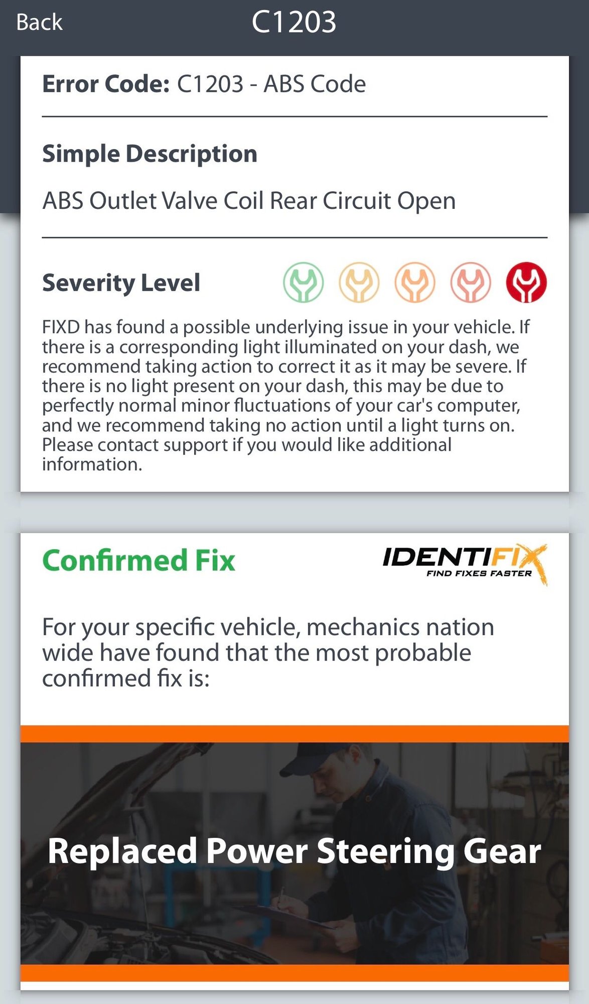

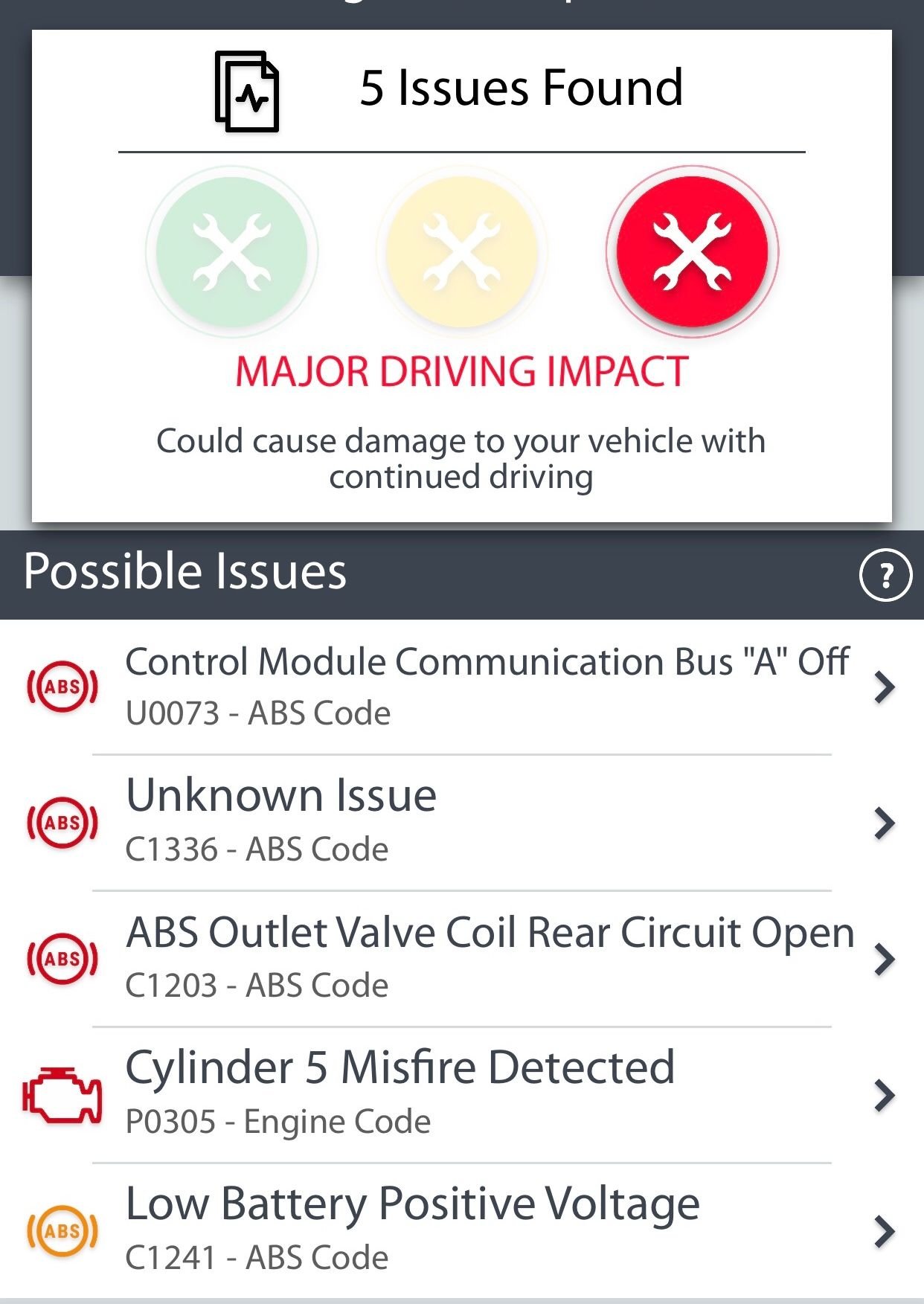

hey I have a scanner and the same issue and all it did was co fuse me more. Codes come up C1203 and P0305

Zero point calibration for the c1203 and p0305 is a misfire cyl 5. Could be funny battery, spark plug, ignition coil etc.

Ok I have a new battery, new alternator. Because first Battery quit. Then new battery Ed alternator and it was bad, so replaced alternator. Lights were not on before that. Now lights on. I’m wondering if it’s the new battery or alternator that is bad? But why would Cylinder 5 all of a sudden be bad?

Really?? Power sterering????

How do you know they're not historical? Clear the codes and then see what pops up.
