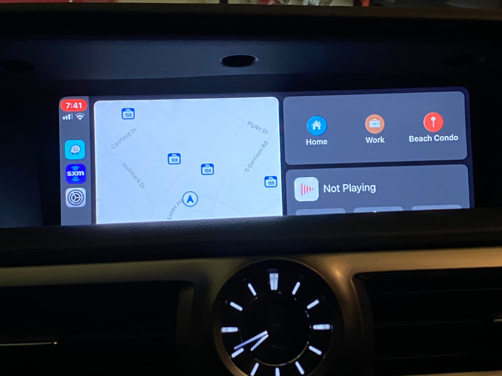

What happens is the apple maps portion on teh Apple CarPlay screen will always look white, like this:
Old Nov 14, 2019 | 12:49 PM
  #514
bob256k's Avatar
bob256k
Joined: Mar 2018
Posts: 1,059
Likes: 275
Instead of apple maps matching the rest of the gui
It happens regardless of whether your phone is in dark mode or not. My phone is always set to dark mode, and mt carplay is always set to dark mode too. What year car do you have?

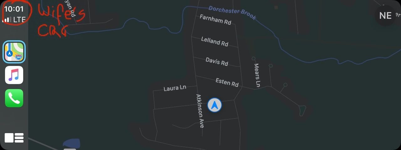

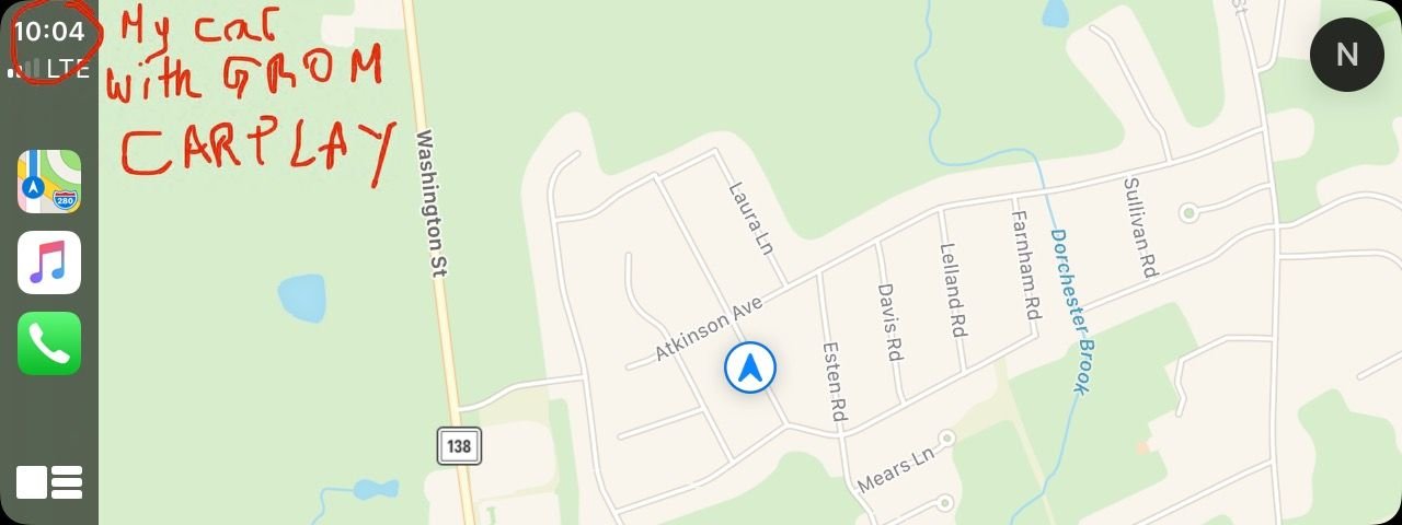

I have a 2017. My wife had a 2019 NX loaner with CarPlay and I was able to test it. Check out the pictures...
My car that was at 10pm
The NX with OEM CarPlay
