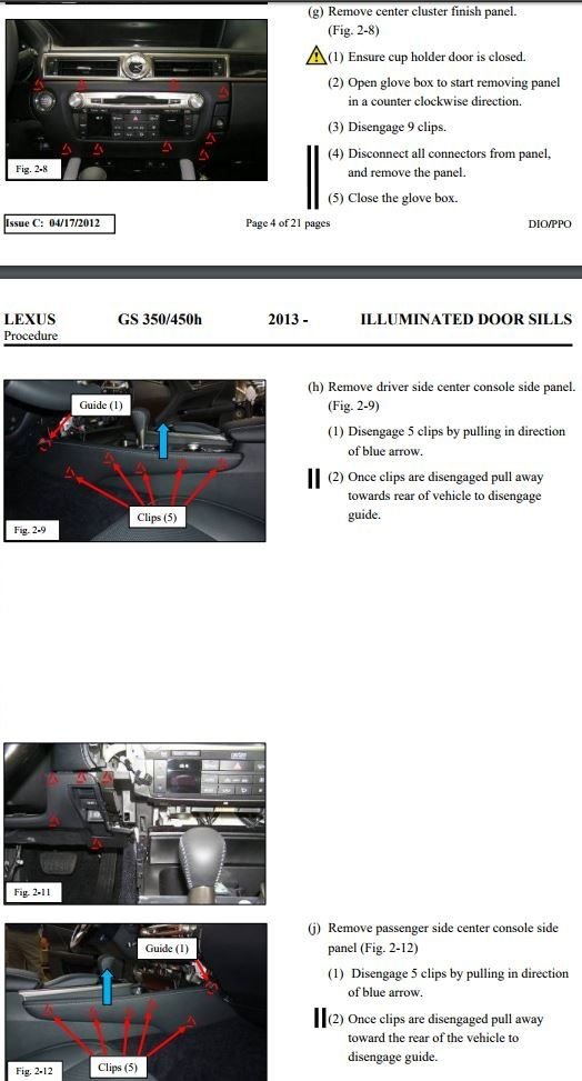

That's unfortunate to hear as it seemed like it might all work with just a swap. I recently had something snag on the shifter boot and damaged the leather. I ordered a replacement shift boot (part #: 58808-30190-C0) which indicates "Beige" which I'm hoping means that the stitching is beige/tan since my interior is Flaxen/Brown. My existing shifter boot has stitching that matches the leather.
When you mentioned the steps earlier in the thread, is this generally what needs to be removed to replace the shift boot (took it from the illuminated door sills instructions):

Update: I followed the second half of the instructions i posted and the instructions posted by fellow member peasados...i started with my current damaged leather shift boot by pulling it down from the shifter **** to unfasten it from the **** (it clips on). Then removed the shifter **** by turning counterclockwise. Then removed the side leather panels from the consoles (they just pop out).
Then, I pulled up on the entire console (carefully) and it popped up its own existing clips. When I turned it over, there was a rectangular plastic piece with two hex screws that was in the way of popping-out the existing shifter boot. Removed those screws and then was able to pop-off the existing boot and replace with the new one. It took me about 30 minutes...
I did replace with the correct 2013 shift boot part number as the shifter boot had beige stitching with matched my Flaxen interior. Big-ups to peasados for the instructions posted previously
