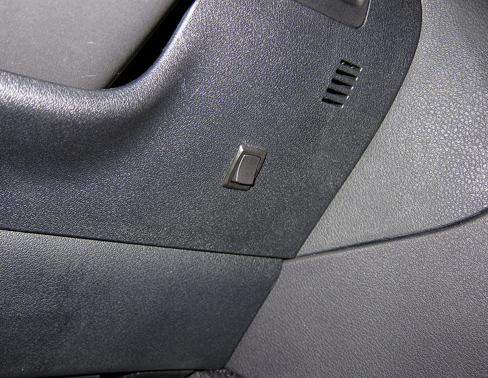

Lightbulb
Originally Posted by rominl
with all that i would just go with the stalk
We came to that exact determination as well......
Or to keep things on the "simpler side"..
This plain black Toggle Button can be done as well for a fraction of the $$ cost...
Photo credit: "javyLSU"
Potential Hidden location would be on the thin plastic trim that holds the "Parking Brake" buttons...
More to come...
~ Joe Z
