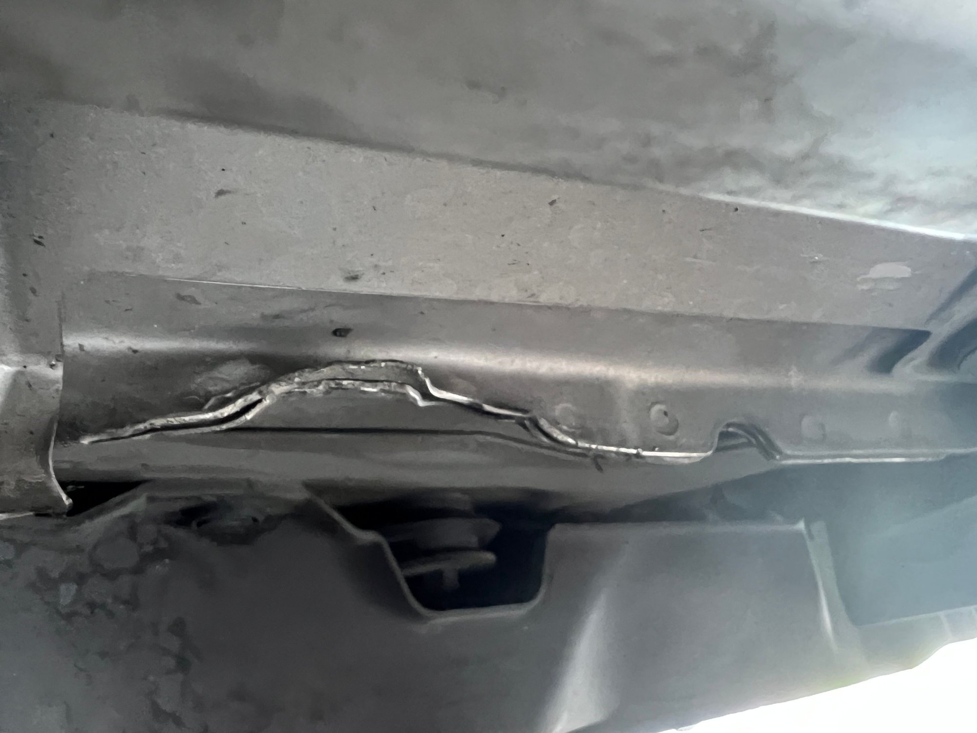

While locating the rear support to jack up my car, I noticed it was bent. It was bent on both side in the rear but the front were fine. For safety concerns, I did not use the jack.
Has this happened to anyone else? Please share your experience.
I will discuss this with the Lexus dealer and Lexus corporate if needed..
Thank you.

Damn those are beat to crap...

That looks like damage which has been caused by more than just one single bad positioning on a lift.
How old is the car? Do you know anything about the car's history (for oil/filter changes, brakes, tires, etc.) where a lift was used before your ownership?

That can be straightened with basic tools. Don't go back to that dealer ever again.

The car is 6 years old. I am the sole owner. It has only been serviced at the dealer I purchased it from. Frankly, I have been increasingly disappointed with Lexus service. Not sure if I will continue doing business with Lexus.

This may or may not make you feel better but 70% of cars with these type of jack points are bent. Anytime you take your car to a smaller tire shop that uses jacks they will bend your jack points.
It doesn't really hurt anything and life just goes on.

Many years ago, I was too lazy to use a pinch weld adaptor, so I flattened the pinch welds on my 3GS.
Later, I resented, so I used a pair of pliers to upright my 3GS pinch welds, and it looks decent now.

It only took me about 30 seconds to bend the pinch weld back.
I still have that 3GS, but I passed it onto my staff to drive.
The front left pinch weld is still slightly bent, but it is now pushed 2/5th of an inch up relative to the door sill cover.
I would have to ask a panel beater to pull it down.
The rear left pinch weld is now almost straight, but fortunately, it was not pushed upwards relative to the door sill cover.

Agree Edgar. Will straighten it out to safely use the jack.

For an area that is made for jacking up a car these are always weak and bend easily. Across almost all manufacturers. Some people use a hockey puck like piece to jack.
I have straightened them out in almost all my cars.
