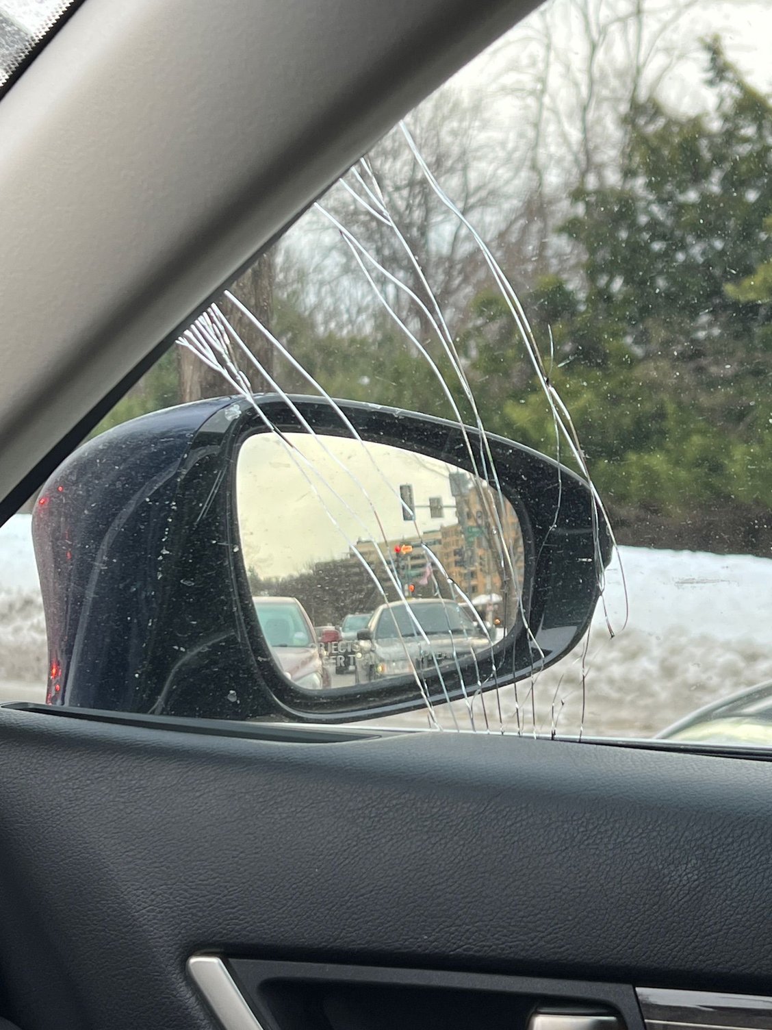

To be clear, when I say "shattered" I mean there are multiple cracks extending from inside the door to the top the glass near the sideview mirror. The glass is "intact" but cracked.
As to your question, I knew there was no impact the first time because the glass was completely smooth on the outside. The cracks were internal. Today, when the glass cracked for the second time, I had just closed the door. No impact.
So, either Safelite didn't install the glass properly (twice, with different technicians) or their aftermarket glass is not up to OEM specs. I lean towards the latter explanation.

August 2024:
August 2024
January 2025:
January 2025

Have you contacted Safelite about this and had them inspect it? If so, what do they say?
I'm curious, has the car ever had damage to that side or to that door?

Whoa how does that happen without shattering? I thought tempered glass would shatter when compromised. Or do you have tint on the window?

Laminated glass?

Maybe it's a acoustic glass? That seems to be "laminated" per description.

Yep, it's the laminated glass--included in the winter package which also comes with headlight washers. No tint.
When Safelite replaced the glass in August under warranty, they claimed the original aftermarket replacement pane must have been defective. I had no reason to question that explanation at the time. But two defective panes in a row? Unlikely at best.
No damage to that door that I'm aware of, but I bought the car in 2022. Certainly nothing on the Carfax. No glass issues until the aftermarket stuff was installed.

Simplest explanation is probably the correct one, poor quality glass. But, both times why did the glass crack in the same area? Could mean that part of the glass is slightly more stressed which is why they both cracked there or something else going on.
