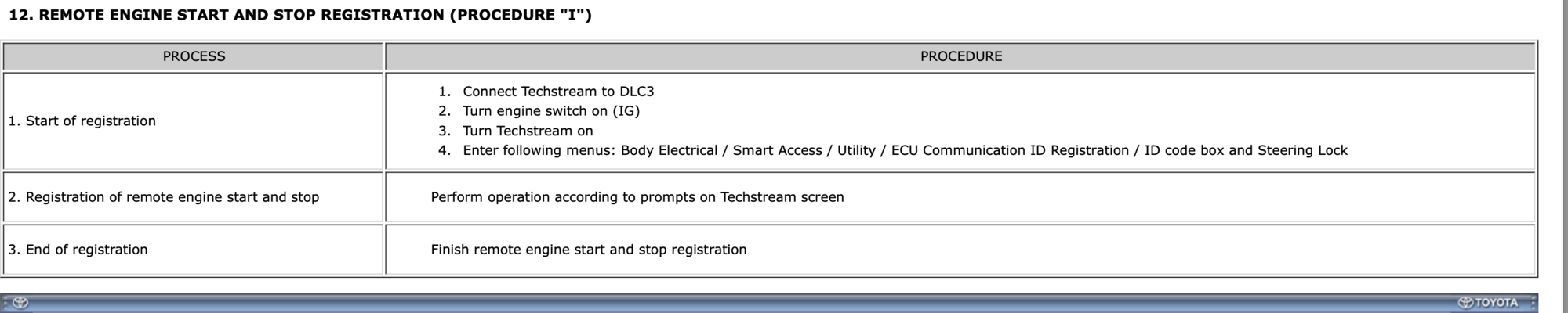

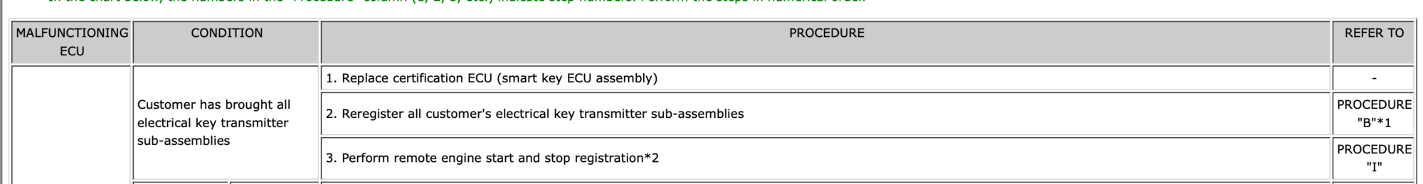

I'm sorry, to be clear, are you saying if I have access to Techstream, I can fix this issue on my '18 IS350? (it's listed in the service bulletin that was posted here).
My remote start feature randomly stopped working some time ago. The one where you push the lock button three times...
Attached is what my repair manual says for this procedure. Since I am not re-registering new key fobs, I assume I can skip to part 3, Procedure "I" ?

@nitroracer - 2018 models need to have a DCM 'Handshake' update made to the DCM (Data Communications Module) in the car. It must be done by a Lexus dealer's service department. Show them the TSB.
