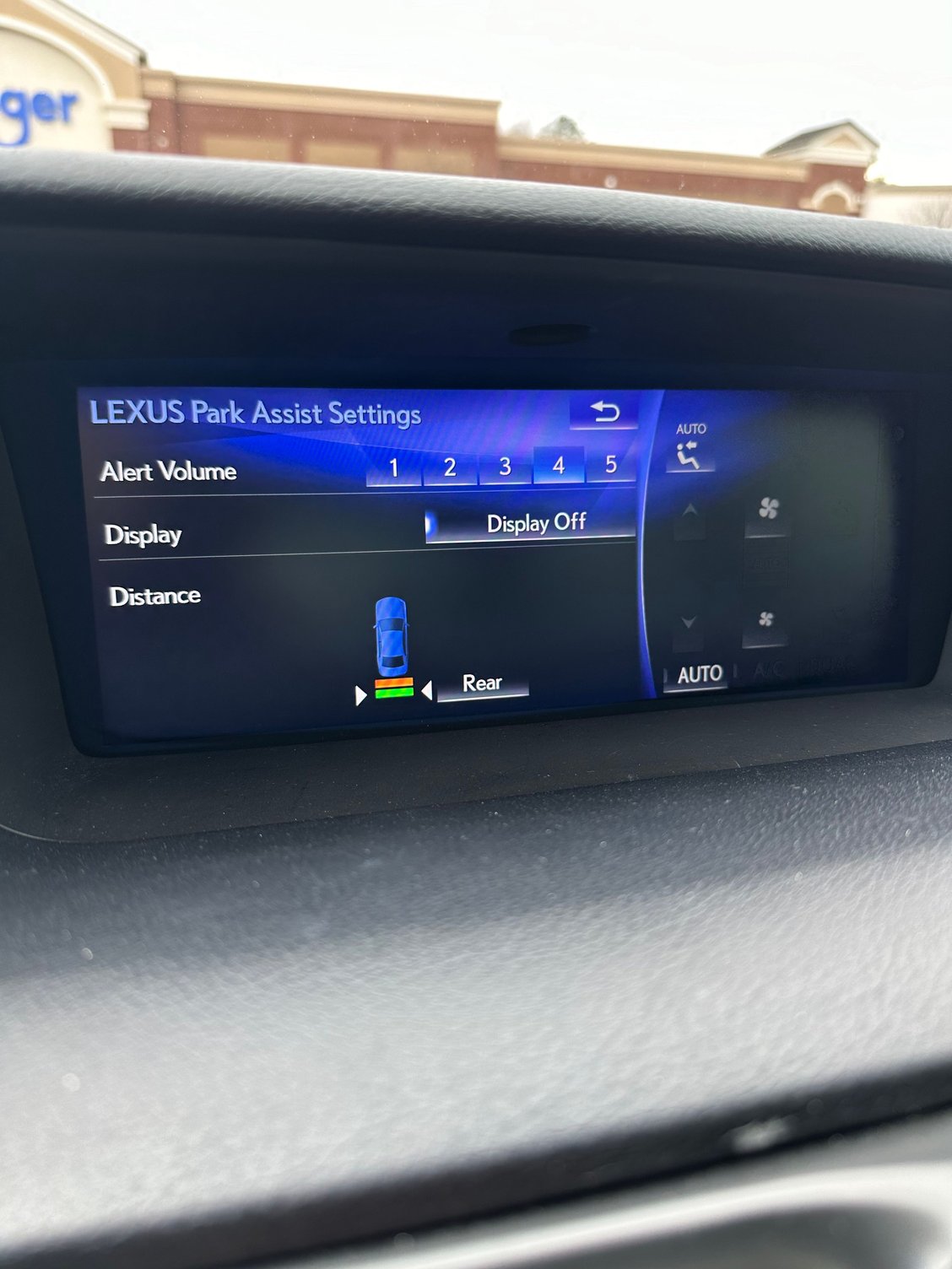

Recently I noticed that my ‘17 GSF stopped warning me when ever I get close to (front) objects. Note: the rear sensors work fine. So I checked the settings and I noticed that I don’t have the “front” option. See pic.
I swear I had it before; am I going crazy?
Do you guys have any ideas on how to troubleshoot this?

Yes.
As I said, I used to get the warnings, like when I got close to my garage wall. But I recently noticed the car stopped warning me in the front.
The back sensors still work, and as shown in the pic, I can adjust the sensitivity for the back sensors. It’s the front adjustment settings that are missing.

Thanks guys, for all the tips and help.
I disconnected the battery for a few minutes, and retested the front sensors by getting close to a wall and the system alerted me.
I don’t know what happened or maybe I am just tripping. But I will say that apparently the GS F only has front corner park aid sensors, because that’s all that shows up on the NAV screen as I was being alerted. (NOTE: I still find it very odd that the setup menu doesn’t allow for sensitivity adjustments to the front sensors, but only the rears)
And I thought the Lexus emblem in the center of the grill also has a park aid sensor (for center coverage), but apparently it’s not equipped on a GS F.
