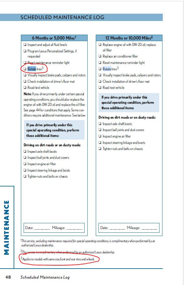

Tire/wheel rotation is only done for GS's that have the same tires and wheel sizes all around. Unfortunately, you cannot rotate the factory RWD F-Sport wheels because the rear wheels (19x9) are wider than the front (19x8). See the notation in the GS's scheduled maintenance booklet below.
If you get a set of all season 245/40 tires, you'll be able to mount them on both the 19x8 front wheels and 19x9 rear wheels, save on the need to buy new wheels, but still won't be able to rotate.
