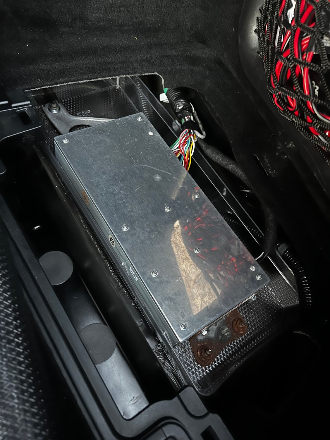

Hey guys,
I know tons of people have had issues with their amps on these and the IS forum. My issue started off as maybe once every 5 months or so I’d start the car and the audio wouldn’t work. I’d hold down the radio on/off button and the system would reset, and audio would restore. Then it became more frequent, and now it’s at the point where it doesn’t play sound at all. Neither from the volume on the radio nor the steering wheel.
I took out my amp, visually inspected it and found corrosion, so like common sense I sent it off to be repaired, only for the sound to not work when it was returned. Repair tech was adamant it is fixed. And looking inside it looks like he did a great job. I even made a little basket to prevent the water from reaching the unit incase it leaks in again (after sealing the vent with duct tape). I read about some instructions to clean all electrical connections with electronics cleaner including the one that’s underneath the center console. Still nothing. Has anyone had any issues with their factory radio (P10082 model)? Amp is good, wiring looks good, fuses are good, so I’m kinda baffled

Just to update. It is a bad amp. Found a buddy who let me swap his out and it works. Goes to say, just because it’s refurbished or fixed doesn’t mean it actually is. For anyone having the same issue, make sure you put a known good amp in before taking everything else apart lol

Just FYI: To help others for this problem. Just about each and every thread that has this problem with the system playing. It's just about 99.9% of the time the Amp. Trouble shooting the whole system before knowing the amp is not bad tends to lead right back to the amp. Especially when you can see evidence of water moisture. The amp can also damage back to the head unit by shorting it out also. When all of the speakers are the same result (not playing) that's normally the key to it.
I have not had any moisture nor water in my trunk amp area at all, but I made a plastic cover over my amp to prevent water just in case. Preventing this problem is the best action knowing that this can happen.
