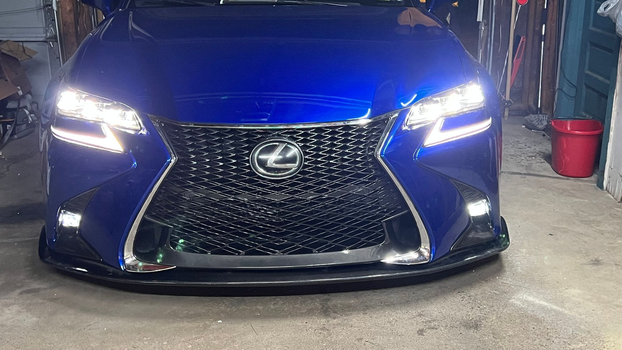

Hi guys I have some problems with my GS350 f sport 2016. (No high beams and not turn off always on ).I make the upgrade and I bought the new modules and I pay for the techstream program and I still have the same problem I can’t access to the AFS and I’m stock in that process. I hope that someone can help me thanks

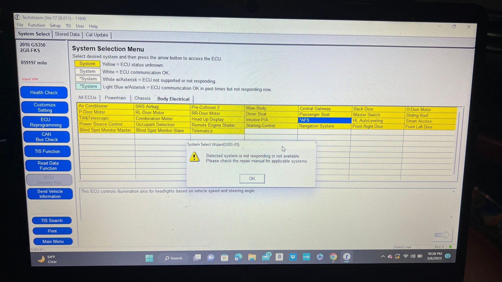

hi it said same error message on techstream the HL AUTOLEVELING same as like AFS
I know that I need to programming the new ecu but I don’t know how

Does your Techstream version work fine to access other modules? It looks like they are all yellow and unknown vs. white for ok communication. I can't recall how it looked on mine.
i can get access to another options but not sure if are modules
