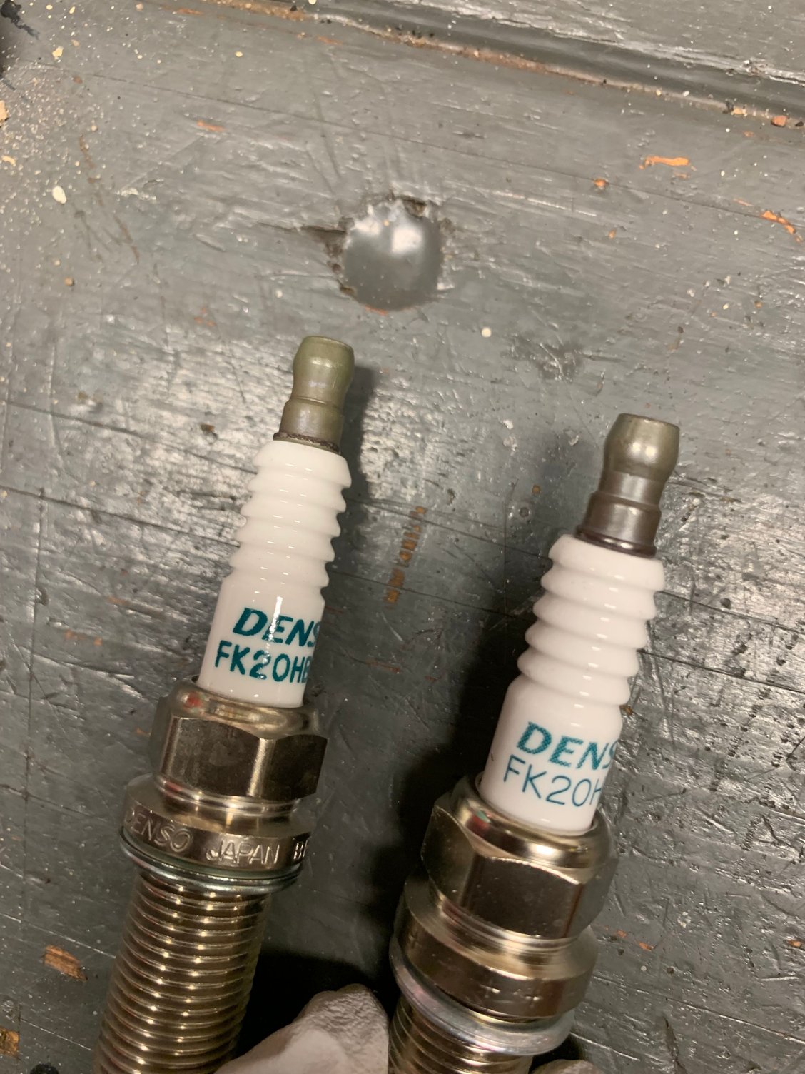

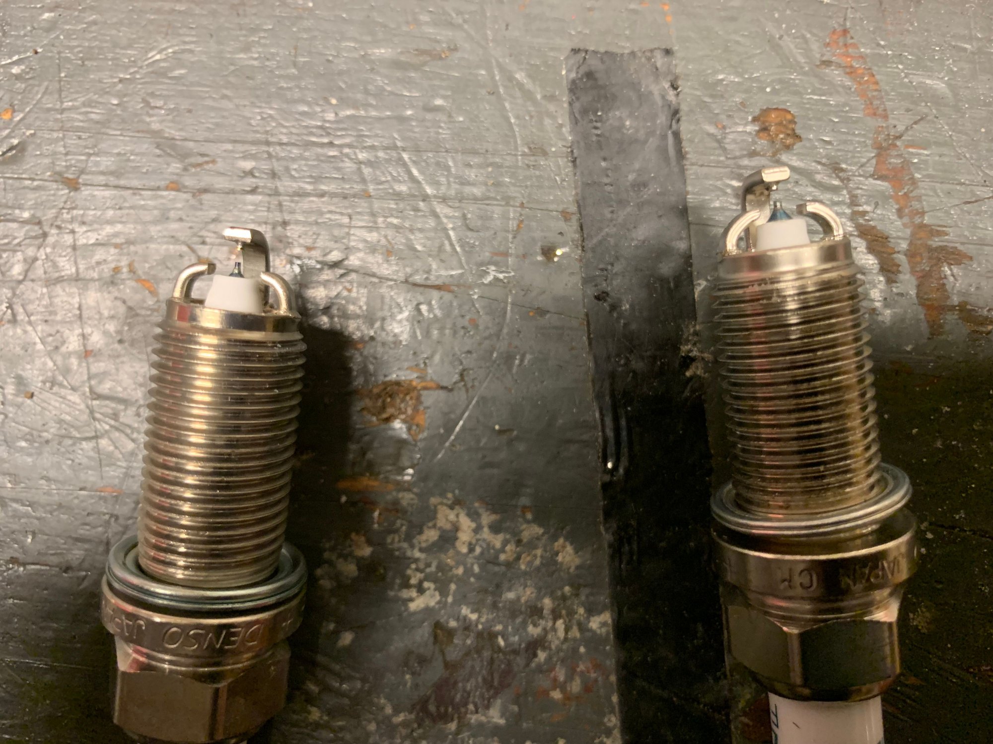

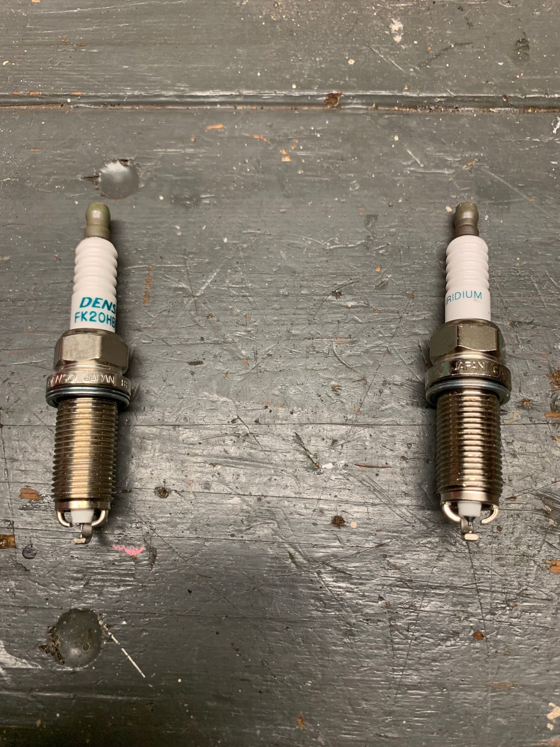

Ok guys I swapped the plugs out last night, but I'll be honest, it's VERY hard to distinguish the difference between the OEM units and the ebay "knockoffs." I had 2 extra "knockoff" plugs laying around (package of 8 was the best deal I found at the time) so I compared them and took some pics, take a look.
The packaging was identical, and the only real differences I noticed was the blue lettering on the plugs (OEM have a bolder and darker font) and the knockoffs have a "+" sign at the top, take a look.
In all of the photos below, the dealer OEM plug is on the left, whereas the "knockoff" is on the right.
Are we sure those are knockoffs and not subtle production changes? After swapping the plugs, the car seems to feel a little smoother (might be placebo though) and there's no CEL yet but scanning DID reveal a pending P0430 code like before, ugh.

Google Denso spark plug fakes. Denso has a write-up highlighting the knock-offs vs real McCoys. There is a difference in lettering and stamping. This forum has discussed this many times and Chinese knock-offs have been an issue on Ebay for many years. I got fooled once by Ebay fakes, but never again. OEM Toyota plugs don't lose their Iridium tips after 10-15k miles. Fakes don't last.
I'm assuming you cleared all codes before installing the new spark plugs. A CEL will only be thrown after two cycles seeing the same issue. Not good if you already have one pending.
I'd also recommend some good premium gas and injector cleaner in case you carboned up your injectors with incomplete combustion from the fake plugs.
Yeah I see that now, wow. I'm glad that you guys helped me catch this.
