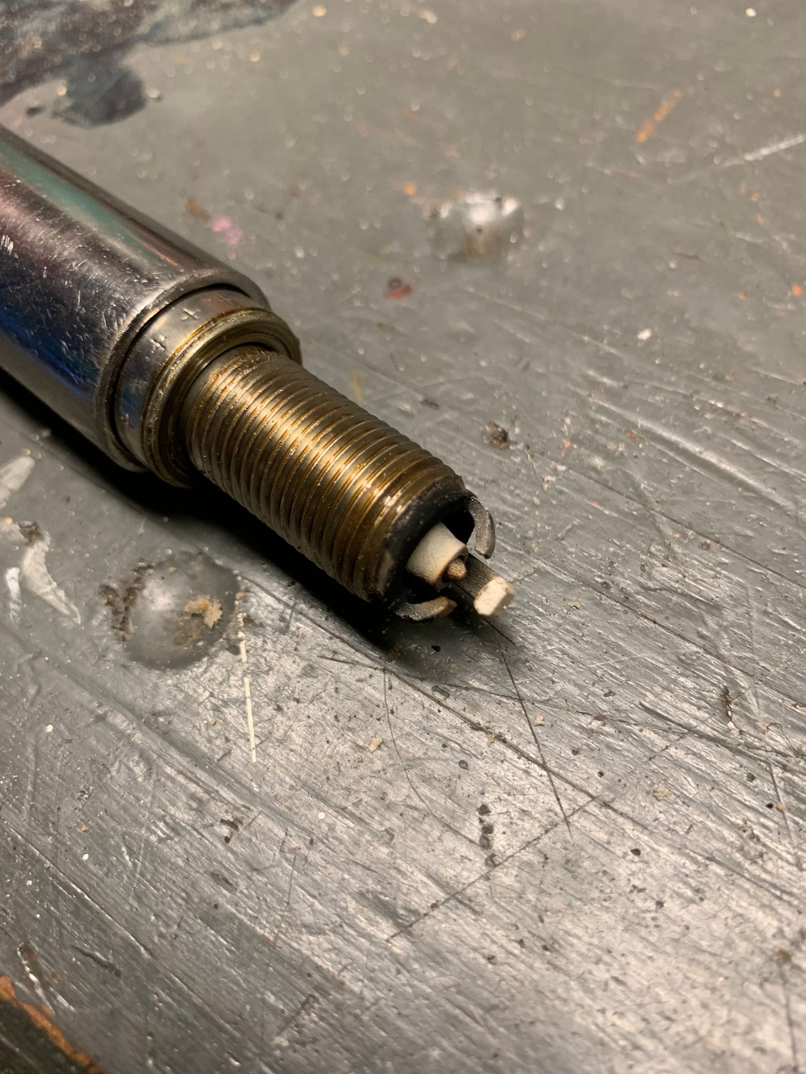

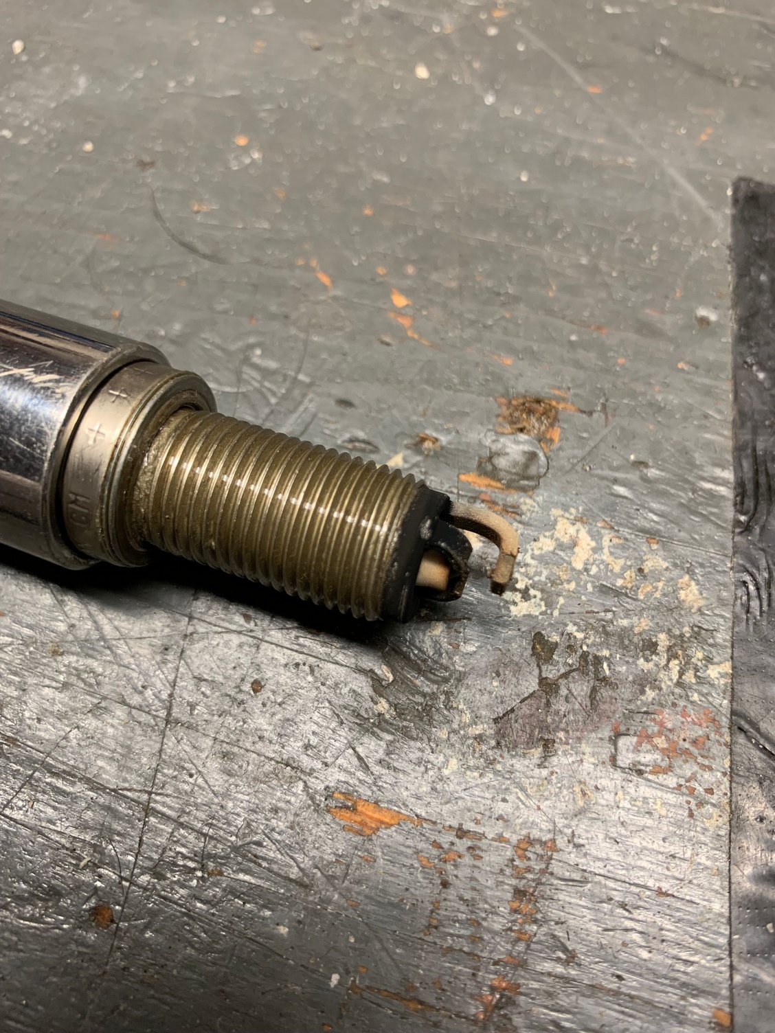

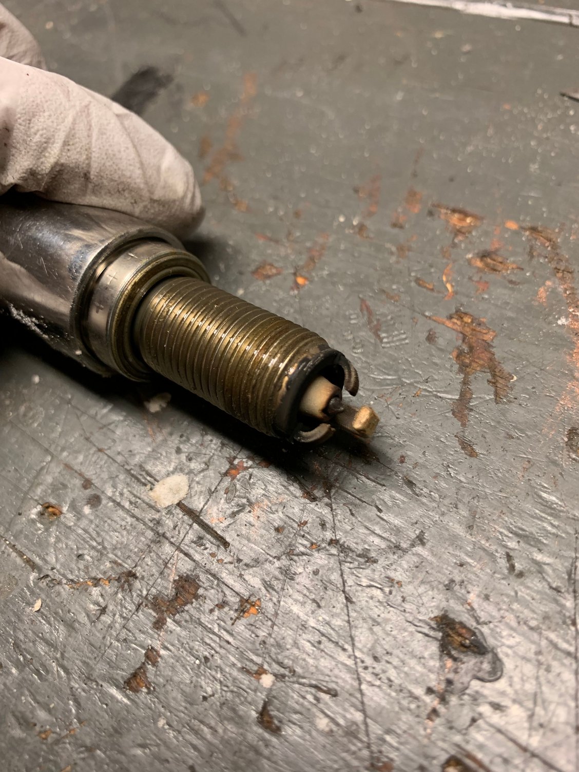

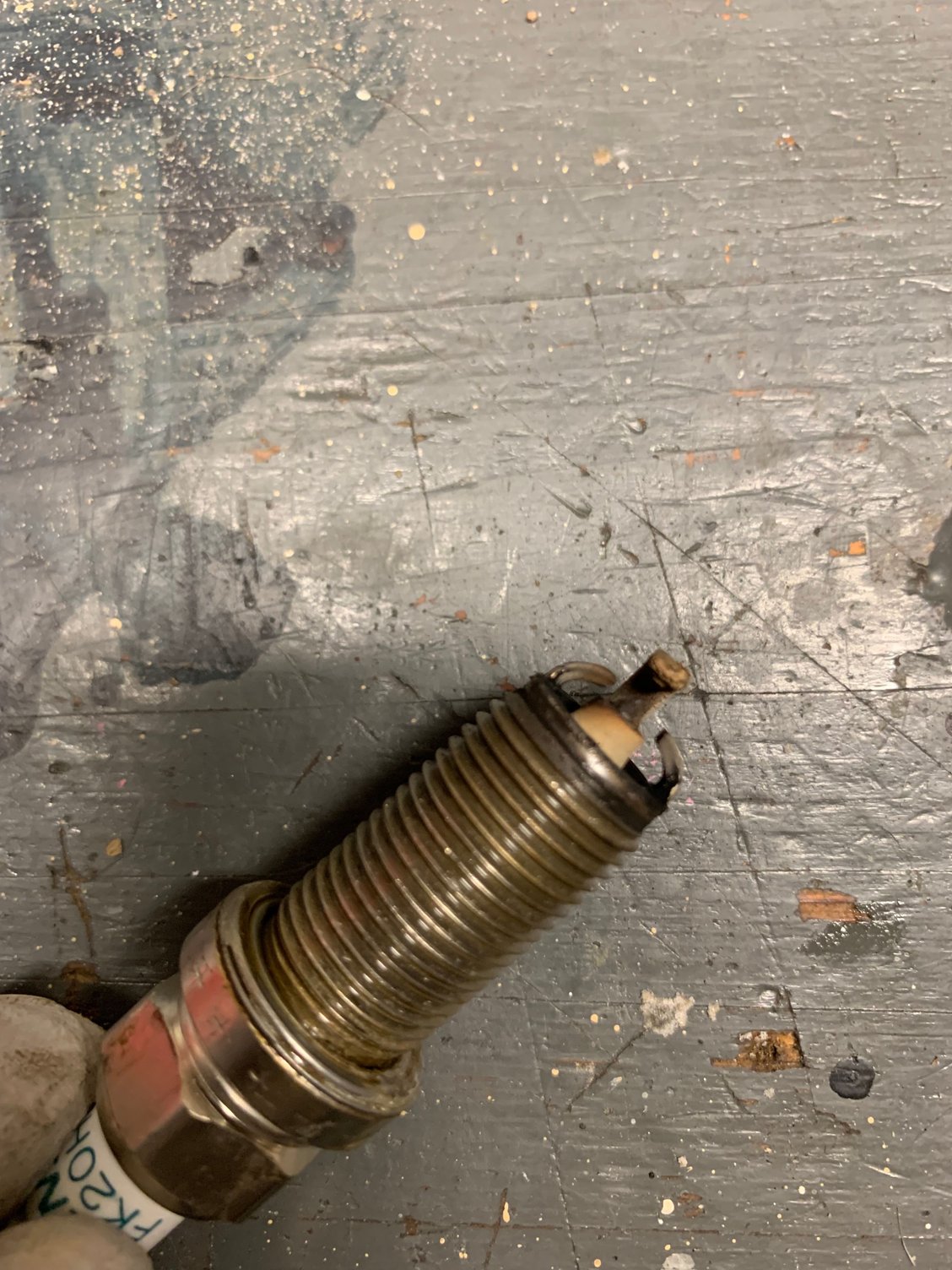

So I pulled the 3 plugs from bank 2 and 1 from bank 1 (only did cyl 1, was running out of daylight and I didn't feel like removing the intake for 3 and 5 lol). Here's how they look after about 20k miles:
cylinder 2 ^
cylinder 4 ^
cylinder 6 ^
cylinder 1 ^
cylinder 1 and 6 plugs next to eachother. #1 is on the left ^

What are your thoughts for these plugs with 20k miles? Definitely signs of oil consumption on bank 2 (with #6 appearing the worst), bank 1 doesn't seem awful with a little oil burning (but granted, I only pulled cylinder #1).

20k miles on these? Did you buy these spark plugs from a Toyota or Lexus dealer?
It looks to me like the gap on most of these is way too wide...even the iridium tips seem to be missing (or really rounded). You need to confirm what I think I see, and if these are too wide or the tips missing, why.

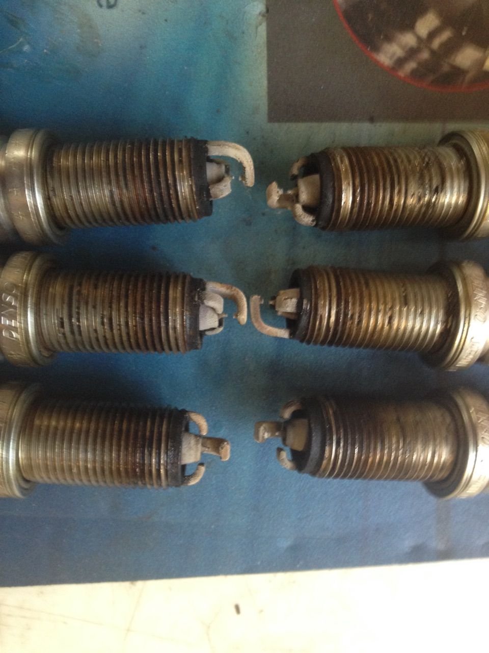

Here's a pic of mine after 100k miles.

These are Denso knock-offs manufactured in China that are designed to look like OEM's. Iridium tips don't disappear after 20k miles. Mine at 100k miles still had good tips. These were probably a good price initially, but really costs you later. I'm shocked you got 20k out of them. Have you had any misfire codes (P0300, P0302, P0304, P0306) to go with your P0430 code?
Buy 6 new plugs from the dealer. I order them online from McGeorge Toyota in Richmond Va. Much cheaper than my local Lexus dealer, even with shipping. Use the Toyota PN.
Install new plugs and see if your CAT code disappears. If not, your CAT may be clogged due to the spark plugs providing poor combustion.

Ebay plugs are almost always fakes only exception is if the seller is an actual Toyota/Lexus dealer. The ones in your picture are fakes you're lucky the entire plug didn't fall apart and rattle around inside your engine.
Ash looking coating is from fuel additives.

WOW... no kidding! They even have "made in japan" stamped right on them. I'm calling local toyota/lexus dealers right now.
Thanks for helping me catch this guys!!! I'll swap the plugs ASAP and see what happens. I will report back soon!
