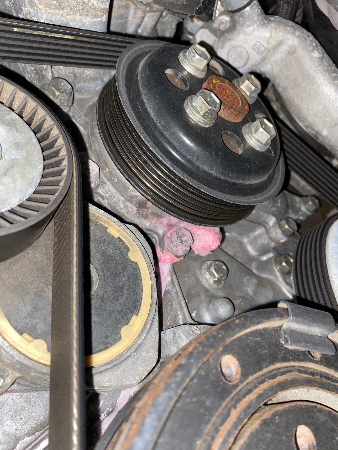

I was changing the sway bar bushings on my 2008 GS460. I looked up from the bottom and noticed dried pink powder on certain parts of the engine. Not sure where it's coming from currently. The car was from an auction so it sat for about 5 miles. I've topped the coolant off once when i first got it. Is my water pump leaking? Car just rolled to 100k miles
Looking up from sway bar area
Closer to the top of the motor

Looks like water pump to me, you can jump on rockauto.com and purchase an aisan brand for under $90 bucks. On the GS350 ours only last about 90-120k until they go. Some will last longer, some sooner! There are several members who put off replacing the water pump and ended up overheating their engines and warping the cylinder heads. So its always best to replace the water pumps on these cars, even if they do not leak.
I would do a thermostat, idler pulley, and new serpentine belt while your at it.

Definitely looks like the pump. Are you losing coolant?

As suggested I would verify that coolant is definitely being lost, and that it's not just dry residue from the overflow tank.

Thats 100% spewing coolant behind the pulley of the water pump. That pumps, leaking for sure! I made a post many years ago, where coolant would hide behind the pulley and load up the backside of it.

Yeah I had to top the coolant off when i first bought the car, but its been at a consistent level since. Toyota red Long Life. The dried on stuff looks old. Im gonna be keeping an eye on it, but also ordering parts preemptively in the meanwhile.
