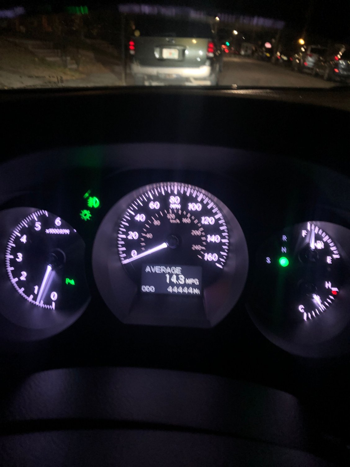

Hello I have a 2010 Lexus gs350 AWD stock17
on my cluster it states that my mpg is 14.3 .
is this the norm ? Car had Now 44xxx on the clock! I read that some people are getting 18-20 city driving.. I wish I can have that ..
if so is there anything I can replace to make it go to that number since I use the car for work for drop off and pick ups.?so miles count!
My last car the bmw 750 was better on gas but it’s also had a bigger gas tank..my fill up are after like 3 days of driving around town...6 hrs stop go pick up drop off... help plz..! Thanks

Are you running name brand high test gas?
How heavy is your foot during acceleration?
Have you looked at a dragging brake or worn wheel bearing?
Other things to check: new spark plugs (Toyota only), clean air filter, motor oil weight (5w30)?
I agree, your gas mileage appears to be low for a car with so few miles.

Damn 21-24 wow I wish!
well I’m nyc so it’s every traffic light a few blocks away! I mostly use 93 gas mobile 1!(more common)
dont know about Heavy foot ant I just filled up at shell 93 (first time) and I starting to try to drive like a grandpa and I’ll see if it makes a difference.. on my next fill up my brake got done2 months ago they check everything and told me they look good ( great long time Indy shop) I use Castro’s 5w-30 synthetic.. air and cabin changed!
Original denso plugs! Waiting for Lexus to get the parts for my car for the fuel rail and fuel pressure sensor to do the recall on my year vin!
I’ll tell them to change the plugs since there gonna be all open !! Hopefully I’m heavy footed and don’t realize I’ll know on my next empty tank if driving slower make all the difference!!
Thanks for your reply !!!!!

That’s hurts that mpg number is there a way I can reset that after fill up on the cluster??
also on the Navi the best the car had was 20 mpg in 2013

1. Air filter
2. Air tire psi bump it up to 38-40 psi
3. remove and clean the throttle body and or do a top engine clean with seafoam
4. clean the maf sensor
5. Take off at stops lights a bit slower and smoother, the killer is at take off
Every know and then on an open highway, mash the throttle to clean out the engine of gunk. Driving to slow often adds more carbon gunk inside the engine. A good thrashing or italian tune up helps blow out the junk out of the tail pipe. Also during winter time, northern gas stations switch to a winter blended fuels that are terrible for gas mileage. So more likely that is your issue

Originally Posted by Mrbungle11
nice all 4s on the clock! i have a photo of mine at the same. have you ever reset the mpg indicator? I think you press and hold the display button on the steering wheel or something. my 460 stays right at 21.4 combined, with a good mix of highway and city driving, and I don't drive it lightly.

Do a battery reset. Disconnect the battery for about 15 mins, reconnect and drive. It will force the computer to relearn your driving pattern. See if it helps.

I did the air up for My tires (for the cold) psi is 36 so you suggested that 38 and up is better for the cold winter! The cleaning I would definitely do if someone in Brooklyn New York someone know that would do it right.. my Indy shop is to busy for that job .. and I rather let someone do that than myself... like I said early I got this last fill up and drove like a turtle to see if it makes a difference and also I’m gonna drive it this one time all the way to 5 miles left to get the actual miles..tbh I never even realize the mpg nor did I hear the little bit of creaking in my dash before I was on club Lexus ... reading all these issues makes you aware of the little issue but it is what it is..Thank goodness my bmw 750 is a weekend car !!
I will definitely do the battery reset as the last option! Ill update you guys/gals after my empty fill-up which will be tomorrow!!!!
many thanks!!!

are you talking about the mpg in the cluster
if so I would like to know how to reset that I’ll appreciate it if you can tell me or remember how or send me a link..
it’s probably on the owners Manuel but it’s in my car and when I’m in the car I just jump in to drive to get that $$$

to reset the mpg on the cluster- while it is showing on the display, press and hold the display button for a few seconds.
