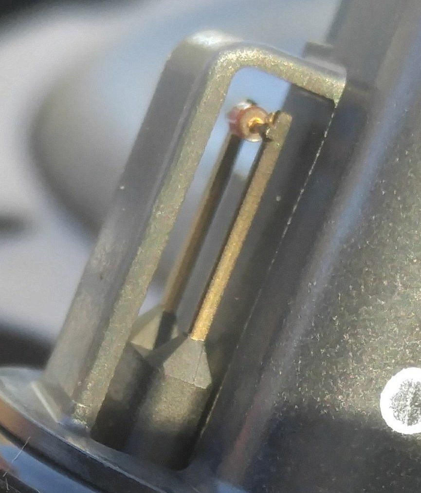

I think if it was knock it would be more audible and consistently with a persistent issue and never make good power when it's behaving. Plugs are shot so definitely worth looking at. Maf pictures attached, definitely dirtier on one side than the other.. Lexus tech said above that timing is quite audible and wouldn't have the symptoms I had. But who knows. Will clean it out, do plugs and see because as it is it's only sometimes unhappy it's still usable and bearable.
inlet side dirtier
Ya those plugs are toast! That maf is dirty aswell! Maybe those plugs are fakes, and not true iridium. I think the ecu pulled back timing because of the plugs to compensate the tune. Once you clean the throttle body and do that induction cleaning she should run like a champ. Let us know how she runs after you finish

Will be using acetone + cotton bud to gently clean the MAF (much cheaper than paying 20 dollars for a can of compressed gas and some acetone lol).
