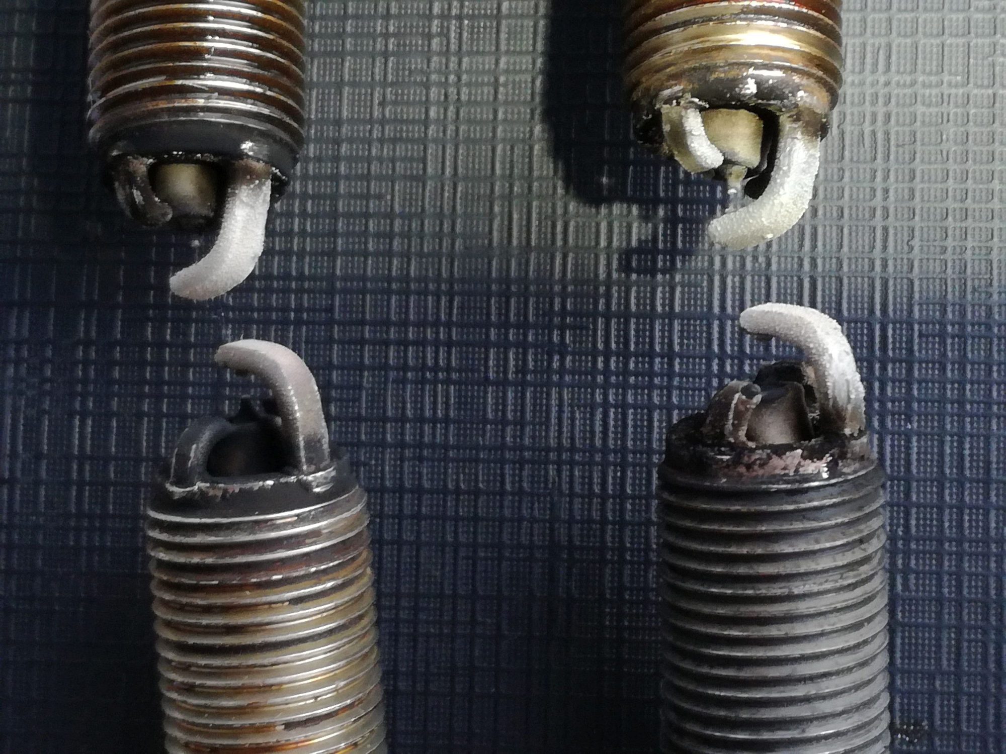

@ibidu1 No worries. Going to dig in LS460 area.
TB was much worse than since last inspection and got a full clean out, rest of plugs done too. One of those green dish scrubbers that's plastic and some alcohol did wonders.
All plugs have varying levels of cover leak except cyl 1, which was ever so slightly brown coloured on top of electrode but was the only plug without any visible recent valve cover leak.. it was pulled during the cool down period after applying top end cleaner. This is the only thing really concerning me at this point - it leads me to consider if it's just cleaner, or related to carbon gummed oil rings, or it's the first few pots to get the heavier crank case vapour (anyone run catch cans?). Oil consumption is okay but it gets a topup ~1-1.5 qt before each change which seems pretty normal judging by other owners feedback but could be a bit better. No smoke only carbon on first heavy accel after a while.
Plugs are arranged as lower left is #1 and top left is #2 (except for 2nd photo which is #5 as lower left)
As you can see below #1 plug has that very faint oil browning while being the only one without a glaringly obvious (current) valve cover/plug tube seal leak..
#5 lower left
#1 lower left
Few days after doing plugs/clean out/etc, performance has returned (and stayed) and improved further (as well as feel) via TB and rest of plugs. Massive noticeable difference to drive-ability, low end response and economy is climbing back up and she goes fast without having to drop down a gear which is great. Partial throttle response is like a dream.
GDI cleaner must have also lubed up the TB to help it work better hence giving a 'false positive'. Before cleaning, rubbing alcohol wouldn't pass through the TB, after cleaning it leaks through. No more timing pulling, it's always positive except two brief exceptions: -1 to -1.5 during rapid off-throttle transient twice in about 50 miles of driving. Long term fuel trims are also halved and the ecu is still re-learning so I get a feeling it's solved now after multiple re-starts cold/hot and a few days. Will take it out for a blat tonight.
Top end cleaner definitely helped but I think another chunk of this was plugs. One plug was loose as hell and it turned out to be caked in burnt oil (the worst plug #3). So compression in that cylinder must have been abysmal... my old XV10 camry wagon had a similar issue and fixing that plug made it be able to go up hills in 5th gear again..
Also been wondering if giving it a tank of e85 might help with top end cleanliness too. Will be doing an oil treatment, then a change, plus pull/clean plugs, inspect, replace tube seals to see if we can get things clean and all running white without oil contamination.
I wonder if using cheaper oil briefly (start, warm a little, light rev then off) would damage the car? Just to flush anything out as much as possible without using expensive oil wastefully.

How often are you replacing the oil in the car? Personally im kind of old school and replace it at 2500-3k miles. On my 350 Im at 190k and hardly any oil burn, never had an oil light come. The 460 and 350 have the same pistons and rings. Guys with 350's have had oil consumption issues, many who have these issues run their oil 5k-up. My theory is that over time the oil collects sand/grime/carbon etc and this gums up the pistons oil control rings.
More likely that white ash is the cleaner that you used. Although they do look oilly
When I do throttle body cleaning I simply remove the throttle body by 4 bolts. I spray it completely inside and out, and open the butterfly to get to the inside nooks and crannies. I will spray the inside of the intake manifold itself with a carb cleaner
8000km or so for oil which is about 5k miles. Car is not used in anger much so it's a reasonable distance but perhaps can try the lower change intervals. As oil ages it does thin out and will get past rings easier if it's going to happen.. Shall have to give it a try, I think you are on to something. 0w-20 is already super thin as far as oil goes which exacerbates this issue. This time we will be changing at 2.5k miles and it's used about a quart or so, no surprise after seeing the plugs.
Intake manifold does need a clean out, it has secondary throttle butterflies as well which must be difficult to get to but are far less of an impact to engine response due to less precision or partial use needed for their operation.
Ash-like coat was present before cleaning and is on most plugs I've seen posted here from other users. It's hard little ***** under magnification, I can post one if you want to see. A clean 460 without oil leaks seems to have white electrodes usually. At first seeing them I thought it was coolant or something and was surprised at all the soot, not used to DI. Reminds me of leaded gas in planes a little, with the white deposits.
The slightly more reddish colour of plug #1 now after closely inspecting one photo, is definitely from the cleaner. False alarm. So PCV/seals/oil cleaner and earlier changes and lets see what happens to consumption, hopefully have nipped it in the bud in time.
Edit: Also have a plug seal failure theory. If you look at these plugs, the front ones have least by far amount of leakage if any. So heat-related would be my guess. We might try run with covers off and see if it reduces heat soak, and run them back to back on vs off IAT + coolant as well.

I would def replace the valve cover seals, if not both sides atleast the side that is leaking on to that spark plug. They do not look too difficult to replace, and should easily come off. While youre at it you can remove the pcv clean and test it to make sure it works, or replace it.
Before your oil change you can top off the oil with about half a quart or a bit more of atf transmission fluid in the oil and run it for about 1000km of easy driving. The detergents will help clean the internals, if you think your internals are gummed up. I use regular castrol gtx oil, 5w-30 with an oem filter. There are better oils that I should be using, but since this is a daily driver, and I replace my oil often its cost effective. Plus it doesnt see high rev nor a lot of heat for me to justify putting synthetic.

S2kiwi hasn't updated for a bit so I will:
ibidu1, valve cover seals are on their way at the moment so will be done in the next week or so. I think it will be an easy job all considered and at a lower cost than expected so looking forward to getting it done. Curious to hear if there's any updates on your situation.
Since the big clean-up and spark plug change our issues are nil. Car runs beautifully, predictably and has the power we wanted. Strange to be driving it and not waiting for it's next hiccup. We still get a little cat smell sometimes, but only if it hasn't had a good run for a while. It's used for commuting and often sits in traffic so every week or two we try to make sure it has a good outing. Smell disappears fast and smells a lot less than it used to. No timing issues etc. Poor car just needed a bit of upkeep, clearly the previous owners' mechanics were not doing their job. We know he tried to sort issues but it appears he was being well and truly had.
We're also doing air filter/cabin air filter/ the trunk release latch and tyres over the next week or two, then saving for the next round. Fluids, water pump, brakes are on the list. I am pretty confident by years' end we'll be up to date on everything and it should be preventative maintenance from there.
