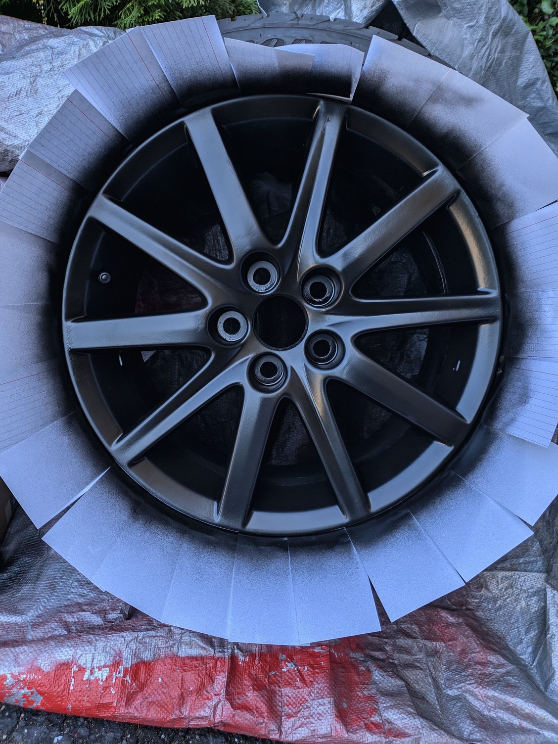

I had that on my previous 3GS and the wheels are exactly like yours, what I did was I sanded the bubble down to make it smooth throughout the whole wheel, cleaned it and then plastidipped it, I was using it for the Canadian winters for about 3 years and it held up nicely!

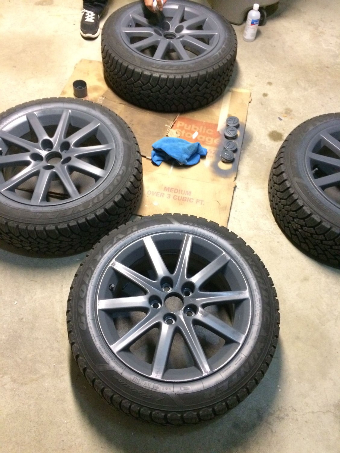

This was the first coat of gunmetal, but it looked more of a matte grey in real life, I changed to black a few months after with a gloss shiner spray and it looked much better than the grey!! If I can find a picture I'll show you. But yeah, it looks nicer than having the bubbles. Rookie mistake, we forget to tape around the rims, but it was ok, we just peeled it off after lol, it was just time cosuming. So make sure you tape around it!!!!

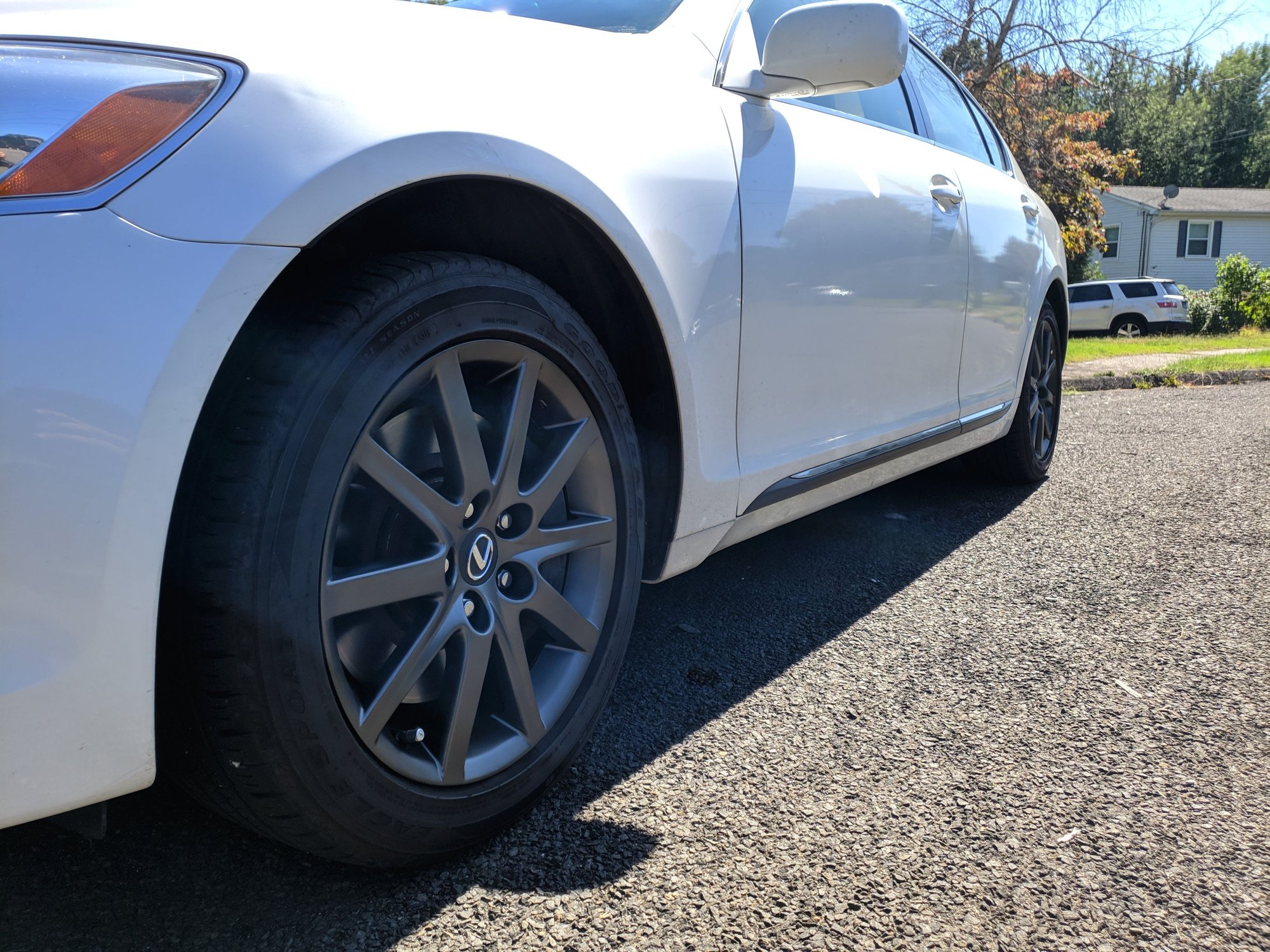

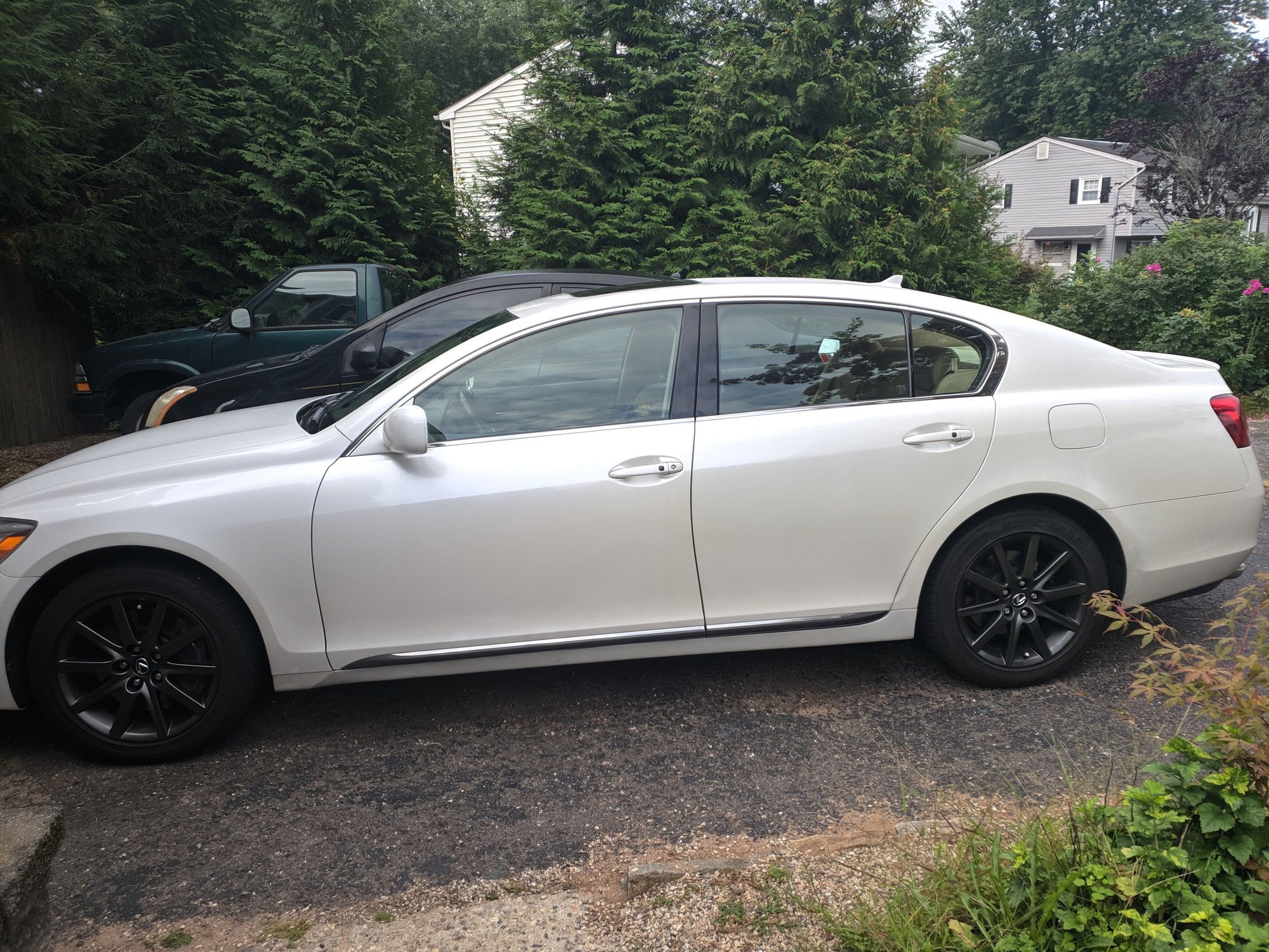

Finally got around to dipping my rims!
