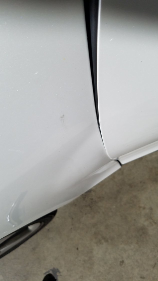

heres a pic of the door hitting the fender. kind of hard to see.

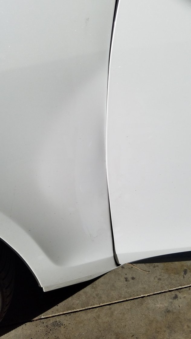

Take some more angled shots, also is the paint chipped on the fender? I say that because you might be able to take it to a pdr (paintless dent removal) guy and have him bend that fender and door back into shape with out doing paint work. Because if you take your car to a body shop they will most likely charge you more to repair that because of the tri stage color, its one of the most difficult colors to match.
Even if that paint is chipped, taking it to a body shop most likely they wouldnt replace the door nor the fender as both look repairable from the pics.
