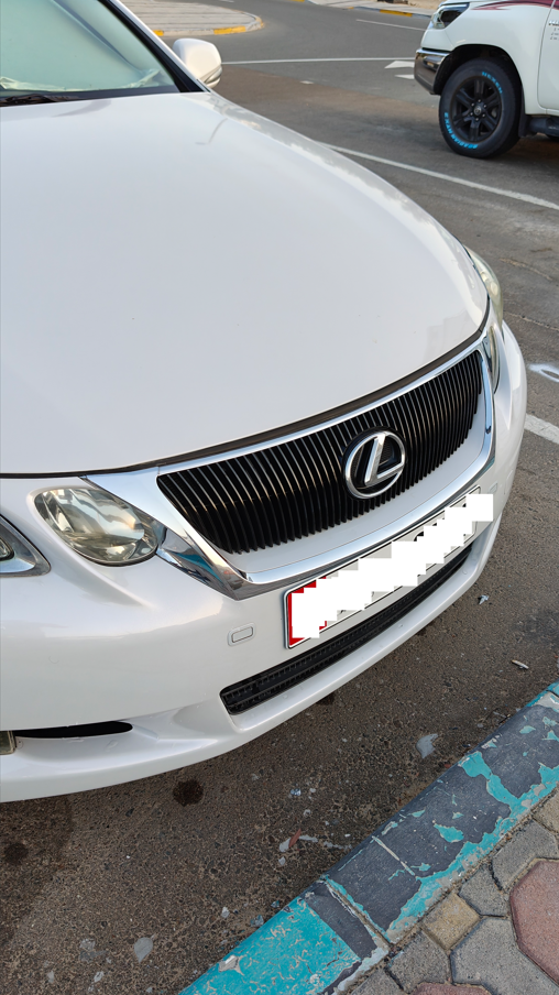

I always looked at the pictures of a fresh GS back when the car was new and wondered if I can restore mine to look like that beautiful rich black front grille:
As you can see my grille horrible peeled and faded black plastic

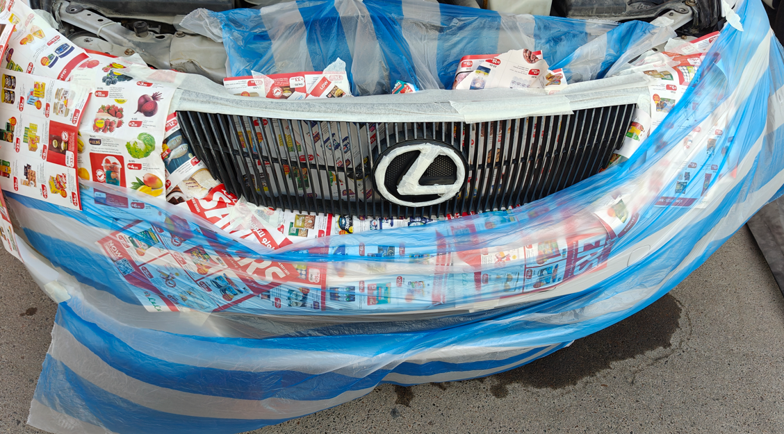

Protect your car paint very well especially chrome bits and clean it very well with water, start spraying and make sure to triple coat it for extra-long life:

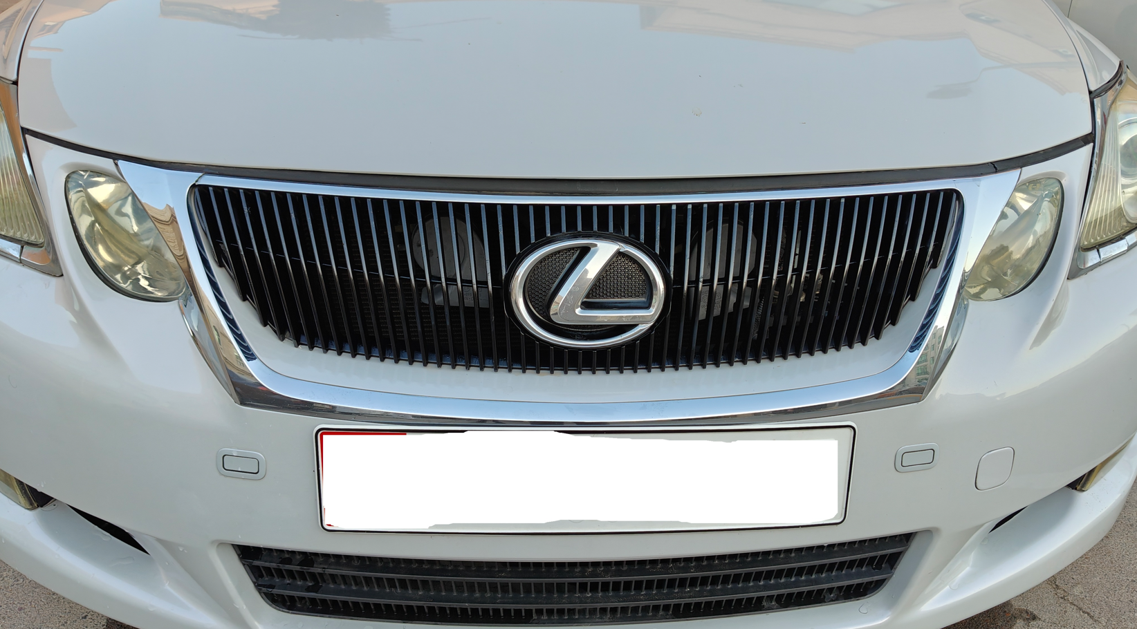

........and there you are almost as deep and dark black grille as a fresh GS from 2008:
(Now of course you can take it to the next level with proper automotive paint and full disassembly with sanding, but I wanted a quick 30m restoration and am really pleased with the result, let's hope it will not fade in a short time)

That came out really nice.
I'm gonna have to do mine now.
