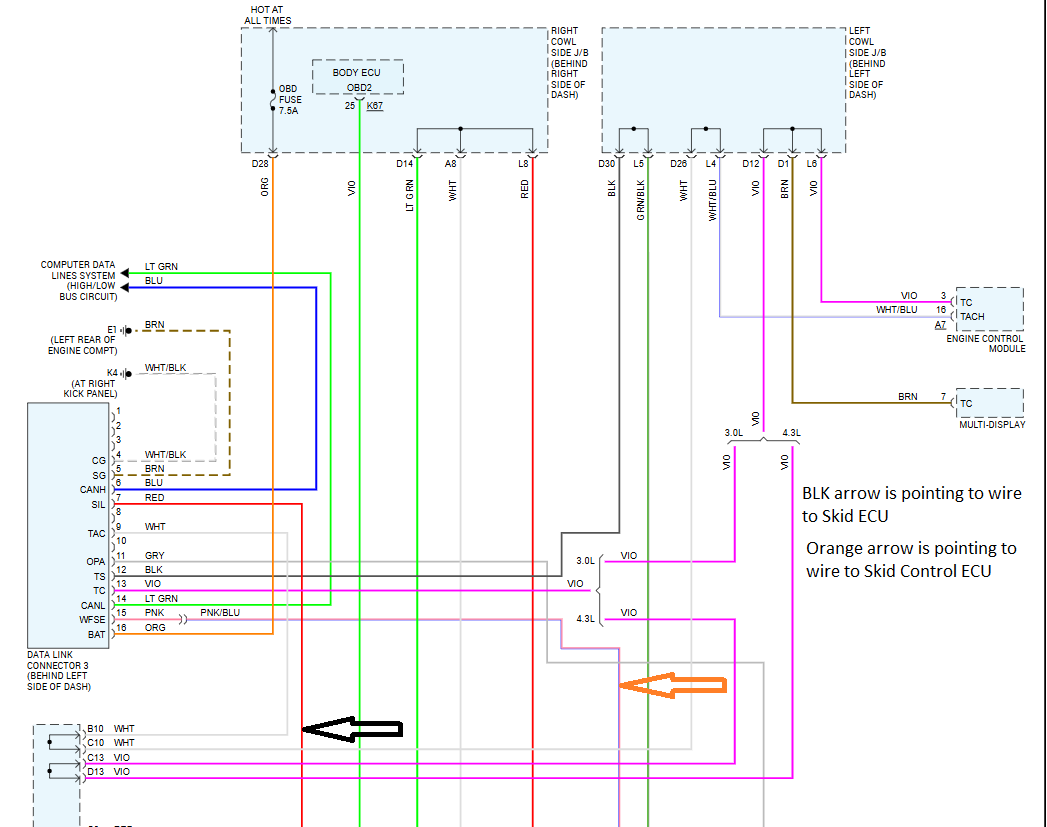

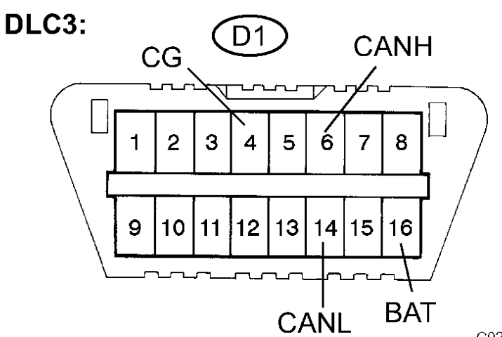

Here you go. let me know if you have any questions. Pin 11 GRY wire is connecting to AWD ECU

still not reading codes, im thinking due to the harsh 2 -1 downshift i have a bad ECU... this is my daily and I deliver for a living... can i just buy an used ECU and itll PNP? what procedure do I need to follow to replace it... id love ot just have it repaired but I cant take the time off...

well im ****ing stumped... i have a car that has no functional obd2 port... when i put a fuse in the obd2 location i get a check 4wd system... ive looked, reiwred, rewired again... nothing.... checked fuses... the only wire out of place is a yellow wire instead of black.. there i no black wire, otherwise all the wires are in place... when i check on fuse #3 there is nothing there, when i put a fuse in i get a check 4wd system, but no power to obd2 scanner

sent teh ecu to SAI, they said they reflowed it... was $190... I think a bit steep for a reflow... should be a reball... but they only took a few days so overall with overnight shipping to and from it only took a week... ill throw it together tomorrow and hopefully all will be well... i found it interesting that there were no codes at all for the trans... the 12v wire for the obd2 port is aol, and i just borrowed voltage from anotehr wire so i could read the codes... that orange wire is deep into the wiring near the bulkhead, and the fuse is good so i dont know about that... i took one look where it goes and will be just borrowing voltage if i need ot pull codes..
